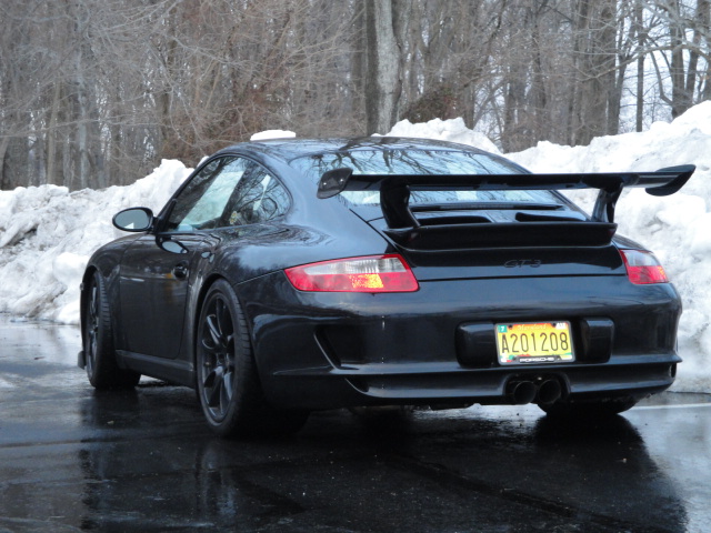

Here is my car.
R&P
Cargraphic Kit 3 exhaust
FVD ECU Software
Remove and replace 3.44:1 (31:9) stock ring and pinion with 4.00:1 (32:8) ring and pinion.
Replacing the ring and pinion of the GT3 transaxle with a 4:1 ratio unit retains the original gears and will not result in abnormal noise. Net effects are remarkably similar to changing and replacing transmission shaft gears with highly regarded reliability. WEe use the Porsche Motorsports 996 RSR ring and pinion set for best quality.
Gear MPH
6 172.6
5 147.9
4 122
3 94.8
2 68.5
1 38.7
