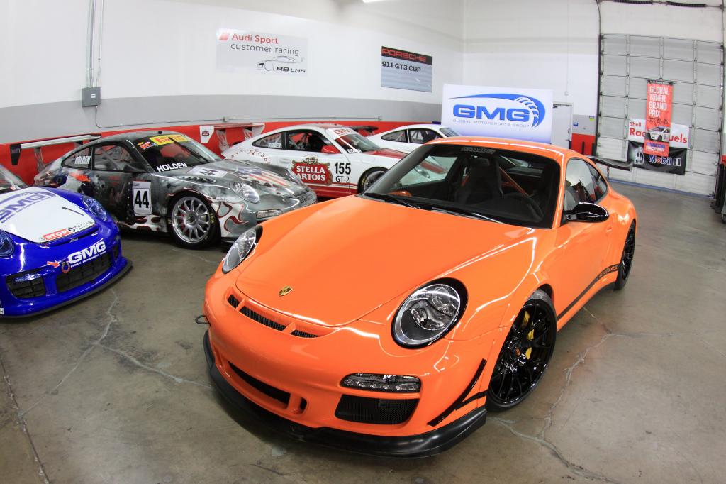

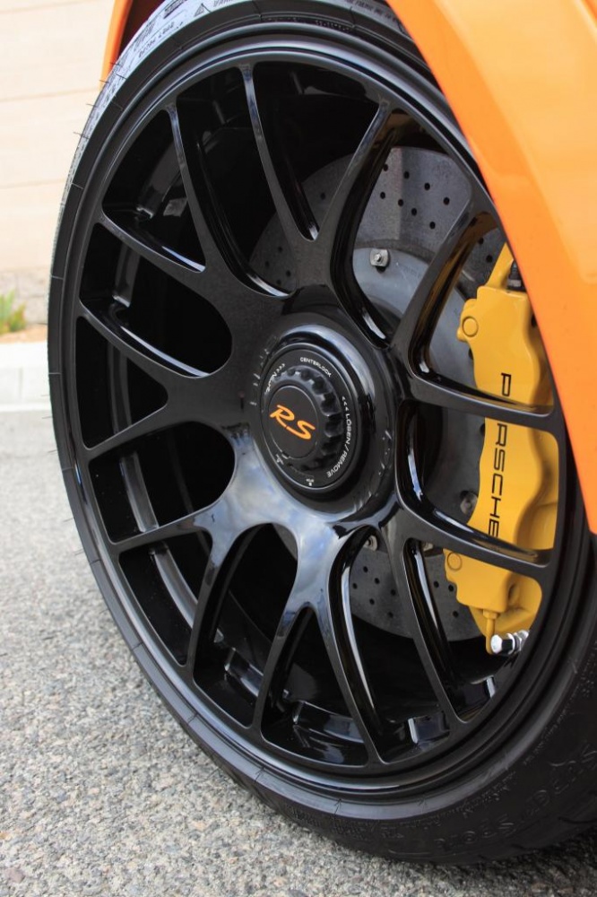

We have successfully done this for a few clients..
Here are pictures of a 08 GT3RS that we did a body update and the center lock conversion.
Feel free to contact me directly for more info..
