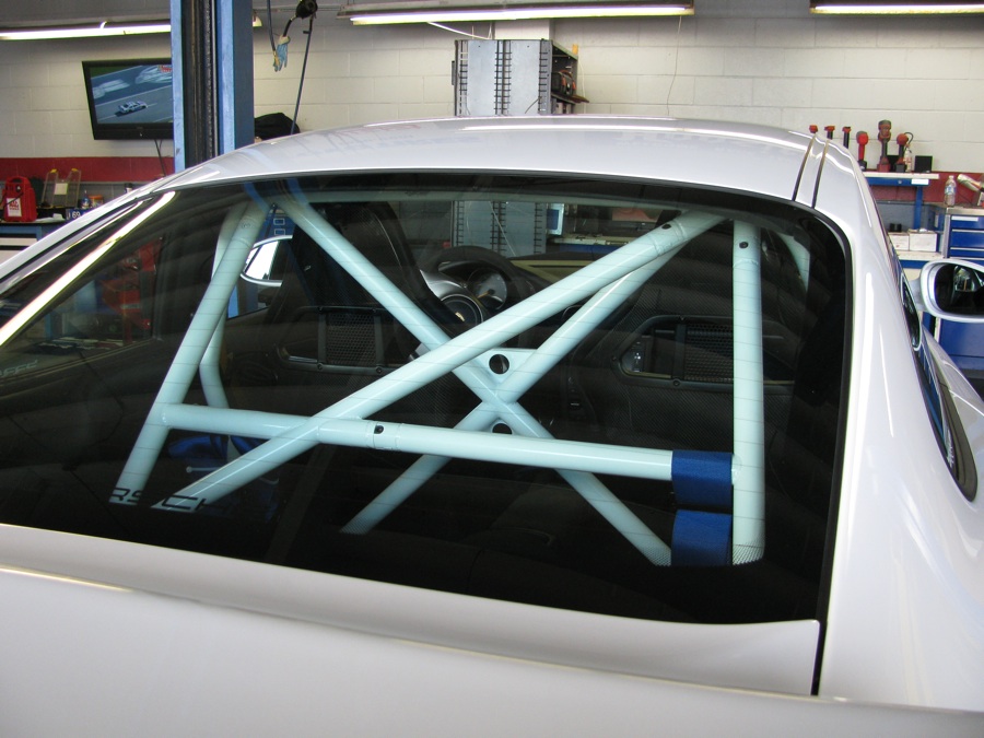

Here is our Streetcup bar
if you want off the shelf bar, sharky can do it for sure.
but you are in the bay area, if you want a real bar, contact tcdesignfab.com, they are 15 miles from sharky and alex knows tony. just ask alex, he will give you the same response.

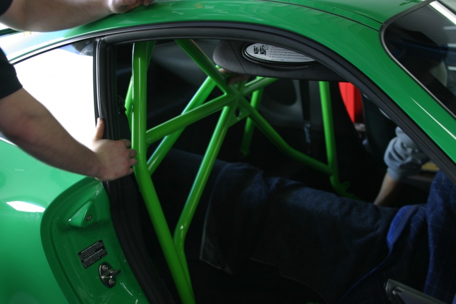

We just a did a 996 GT3 track car for a client just search the forums we documented the entire build process.

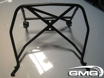

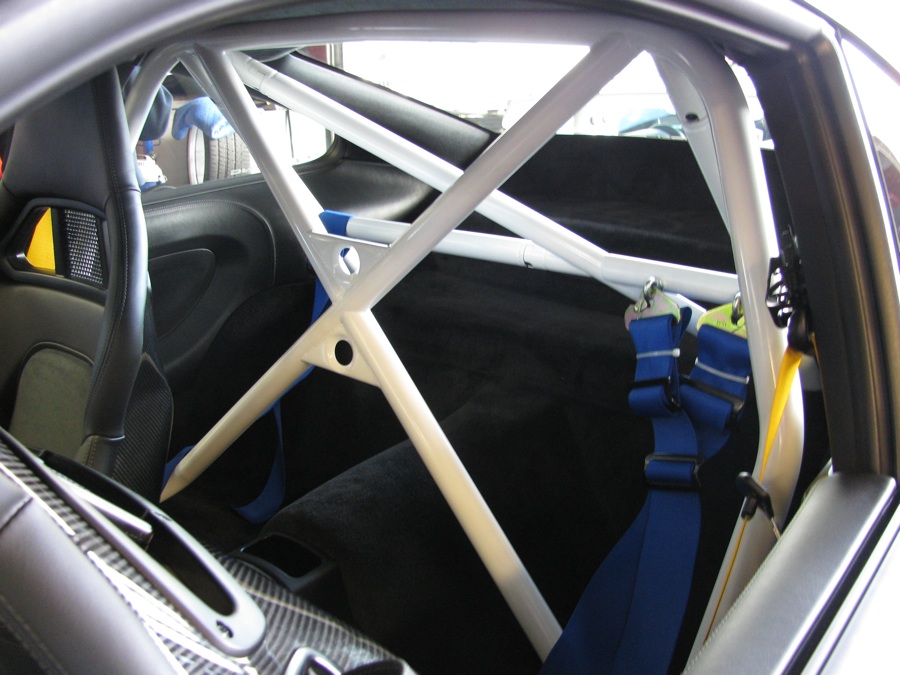

We have done many of these for our Porsche clients in the Bay Area...and even had one unfortuneate situation that proves the need and value of the safety equipment.
One of our customers, who had a 996 GT3, rolled his car at Thunderhill coming out of turn 9....rolled it several times. He had the GMG roll bar / harness bar / shock brace / Sparco seats / full harnesses...and walked away without a scratch.
We also have a couple of Porsche in our storage facility that have all the safety gear installed if you want to take a look at how the installation works, and how it completely bolts into the interior without any fuss or mess. We have a 996tt that is tracked regularly, and will attach some pics of that install here, and we are getting ready to do another 996tt for another customer. We also have our well know 2010 GT3 which also has the full compliment of safety gear.
On our most recent install, the customers confidence and comfort from the harnesses and seats improved some much that his lap times dropped 2 seconds....with no other changes to the car.
Let us know if you have any questions, happy to show you the options and optimal solutions.
Can provide more pics if desired.
We have done both Porsche seats, and Sparco race seats, both able to continue to use the stock seat belt harness as well for daily driving...alll sorts of options here.
