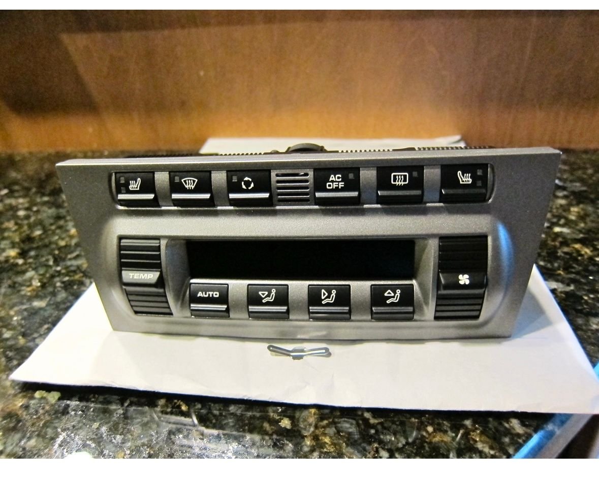

Next you need the HVAC Climate Control Unit. Part # 997 653 111 14 (Note the last digit can be 1,2,3,or 4. 4 was the most recent update.) These can be found used on ebay and other internet sites, as well as new from a dealer. I used Sunset Porsche.
I swapped out the seats and the control unit myself. Directions for those steps can be found on other posts. Planet 9 has a good article on PCM install that shows the Climate Control Unit removal.

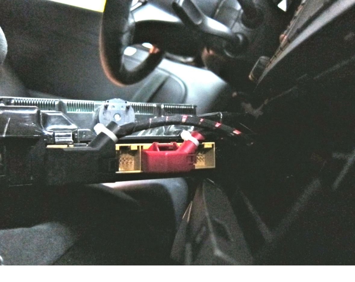

The wiring harness for the heated seats connects exactly like my non heated seats did. The only problem: no wire was present to connect seat heaters to Climate Control Unit . My pals at Harper Porsche, the Knoxville dealership came through with the solution. A wire was ran directly from the Climate Control Unit to the seats, under the carpet of course. The final challenge was the wire connection. Jason, a Porsche Service Tech did a lot of research. This is the Gem of this Mod. Those connectors are a BMW part. Jason tracked them down and eventually acquired some. 30 cents each. Originally used in an older M3. (This has to be an abomination of some kind!) Hardwiring is an option but he was reluctant to go this way.

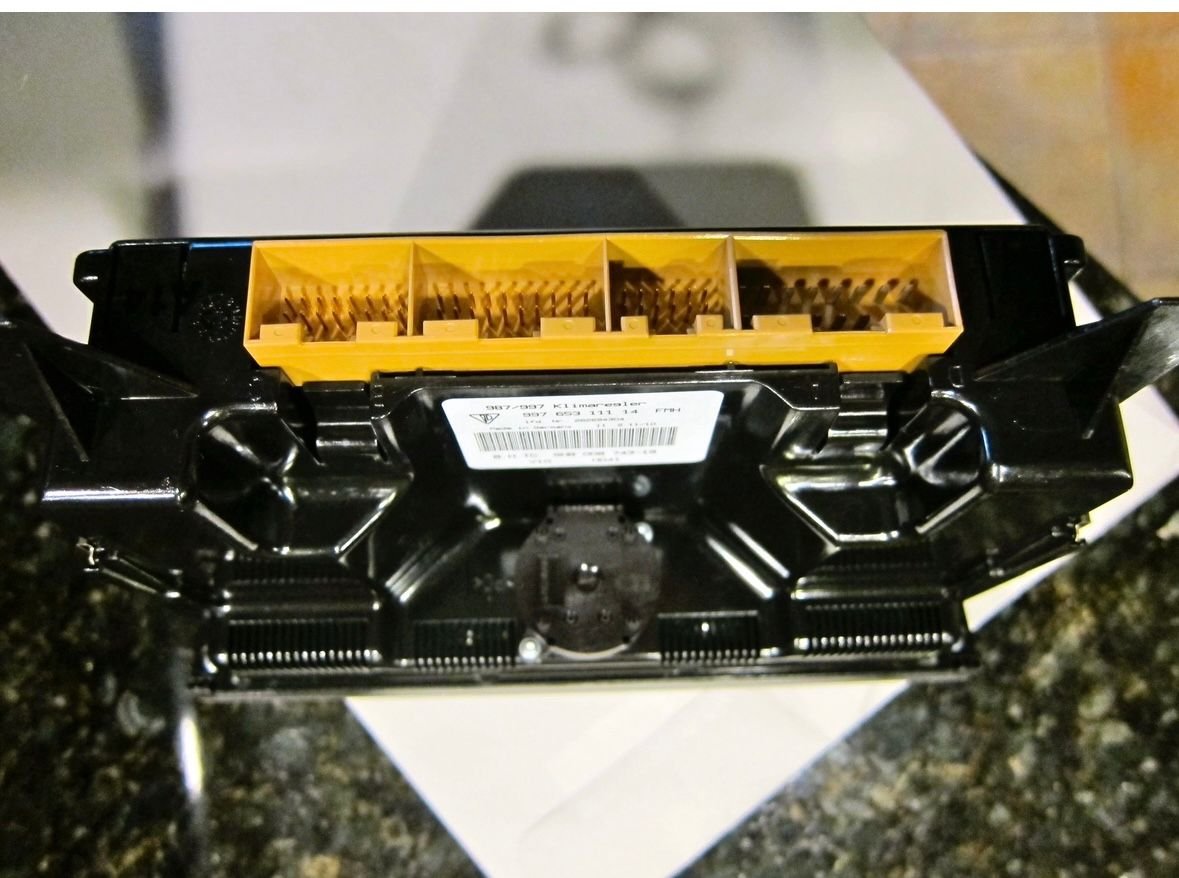

BMW Parts:
Part #61.13.6.913.612 Four each.
Part 61.13.8.364.848 Four each

Back of control unit
