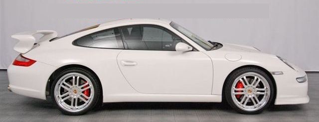

2008 Carrera S with GT3 kit
Hey bud! I just bought my 2008 Carrera S which came with an OEM GT3 wing. I do not have any details on it, but at least you know it is technically possible to have the wing fit this car.

If I understand it properly, a standard Carrera (997.1) and GT3 (997.2) decklids have the same mounting, hinges, and overall dimensions. So fitting the decklid shouldn't be a problem, from what I can tell. Maybe consider upgrading to the GT3 rear hood shock, I believe it's stronger.
The airbox? Well, the lower box mounts are the same on both Carrera & GT3 models, but I'm not sure about the hose connection, or any other pieces which might impede the installation. I'm guessing a custom hose could be required to fit a GT3 airbox, looks like the GT3 throttle body will be much bigger. So, I doubt it's a direct fit with factory parts. See if your buddy will let you borrow his airbox for 10 minutes. haha
If it came with the decklid harness, then the fan should work properly. The same fan is also used on Carrera models with Aerokit, so from what I can tell, it's fully compatible. If you don't have the harness, you will need it. Let me know, I think I can help with that.
If you have any other questions, send a PM and I'll see what I can find. Best of luck, this would be a cool decklid! Just try to test it before you buy it, if possible.
