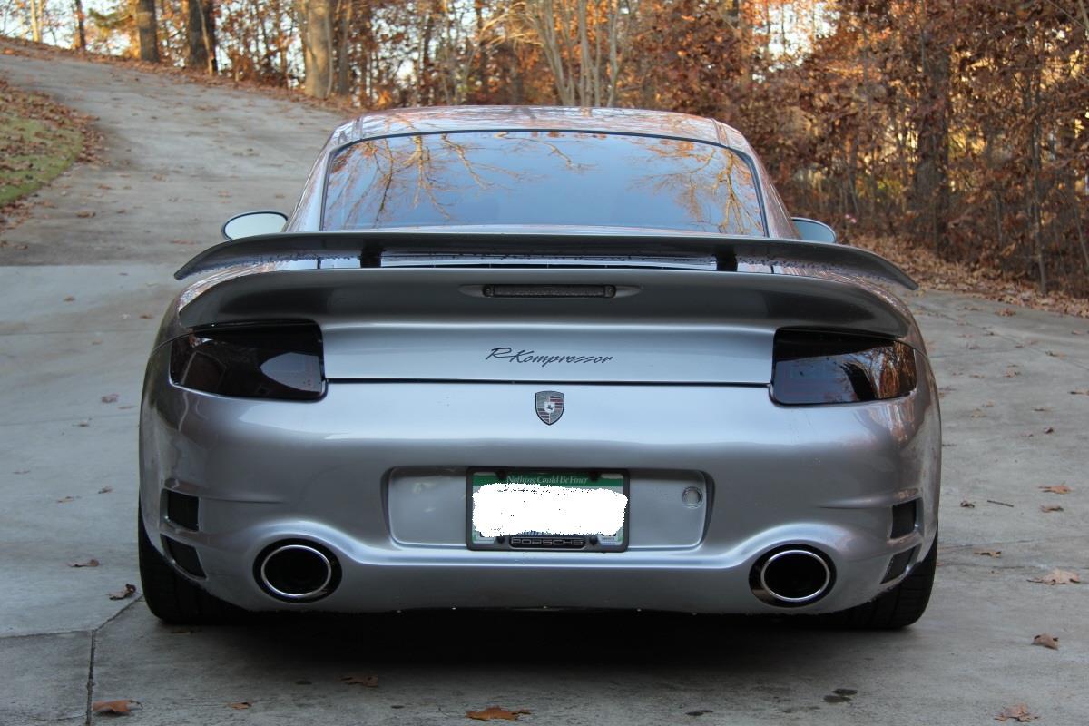

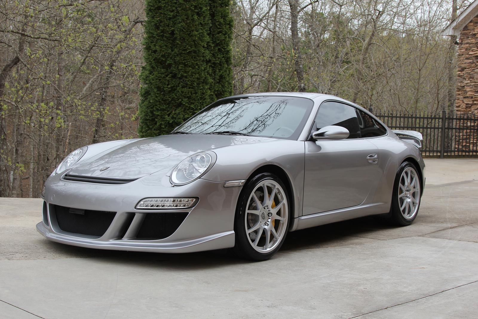

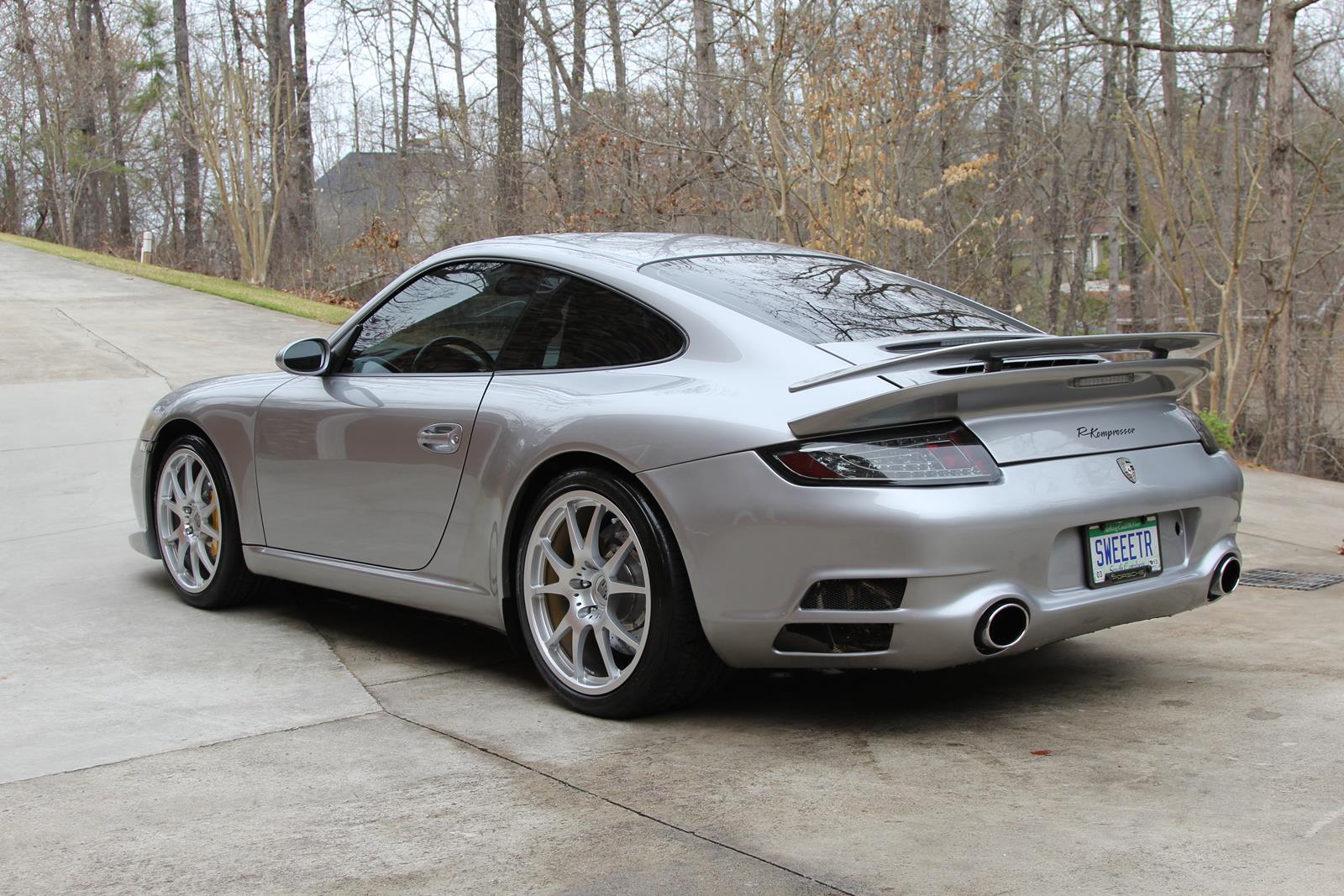

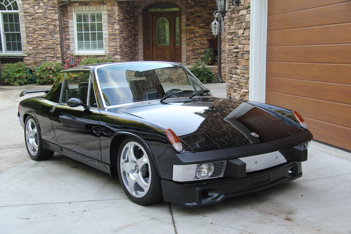

RSS Parts in my Street C2S or not
I have a 997.1 C2S and have acquired the full RSS lot of suspension goodies to install along with a Bilstein B16 Damptonics setup, however, I'm having some second thoughts about putting some of the RSS parts into the car since it hasn't and most likely won't ever see a track. I do like to drive it fast and up in the curvy mountain roads, but it spends more time around town and on the highway than it does doing spirited play. I've had my car for about 18 months and it has a RUF Supercharger kit in it with Fabspeed Intake and full Fabspeed exhaust, which should have it putting out HP #s somewhere between 450-475 conservatively. I'm going to the Bilsteins because I feel the factory PASM suspension doesn't have enough rebound dampening, especially in the rear. Pushing the PASM button helps to stiffen it up, but it doesn't make that wallowing rear end feel completely go away - I'm hoping the Damptronics will and from everything I've read, should. My dilemma is with some of the RSS parts and exchanging out all the rubber equipped suspension components for bearings and monoballs. What I was planning to install are:
  • Front & Rear Lower control arms with the monoball end and adjustable solid thrust arm bushing.
  • Rear Dog-Bones Kit
  • Rear Toe Control Arms
  • Front Toe Link with Bump Steer Kit and Locking Plate Kit
  • Front Tension Compression Link
  • RSS Solid Adjustable Front & Rear Sway Bars (19.5mm Front & 26.5mm Rear) with Tarett Adjustable Drop Links
  • Tarett Front Suspension Monoballs (these aren't really optional as I'm installing a Cargraphic Airlift Kit from a GT3 so I need to go to a monoball front mount for compatiblity with this kit)
Based on my description of how I use the car, which of these would you do, and which would you not do to avoid an excessively noisy or harsh ride on the street? I will also mention that I have a heavily street modded 914 that has a front Roller Bearing suspension in it from Shine Racing Systems and I don't have any issues with ride quality or noise with that - just a much more accurate steering feel and more precise suspension travel.
Here are a couple shots of the car that will be receiving the upgrades - threw one of the 914 in as well . Thanks in advance for your suggestions.
