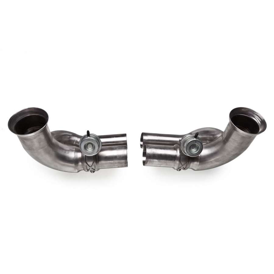

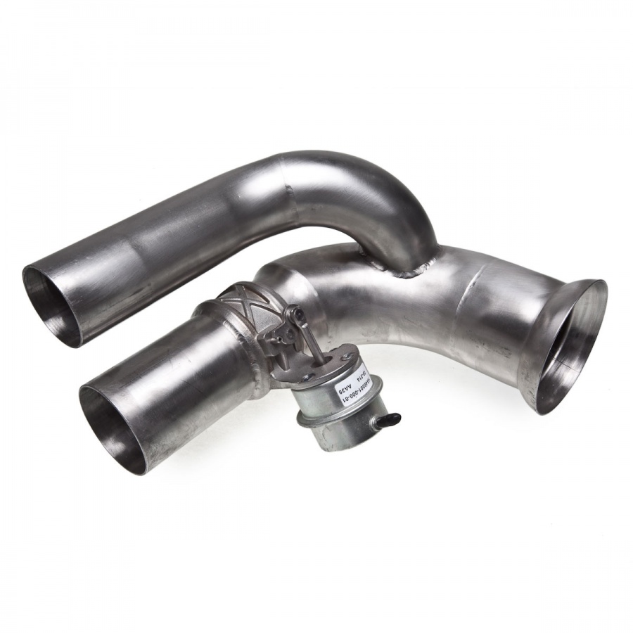

We've also got a side muffler bypass that would save you tons of weight. Includes valves too so it's not overly loud all the time.

Hey Tom
It said the site was under construction but based on the pics how do you control the valves? Assuming it using the sport button line to control?
Can you pm me details please? Thanks!

Yeah...sorry about that. Our site was taken down by some hackers just after Christmas and we're still trying to get it back up and running.
These muffler bypasses are made by Tubi. The valves on them are controlled exactly the same way the valves on the factory mufflers are... either by the sport button, or by vacuum under hard acceleration.
Curious will this set up connect with the Shark Werk bypass?
