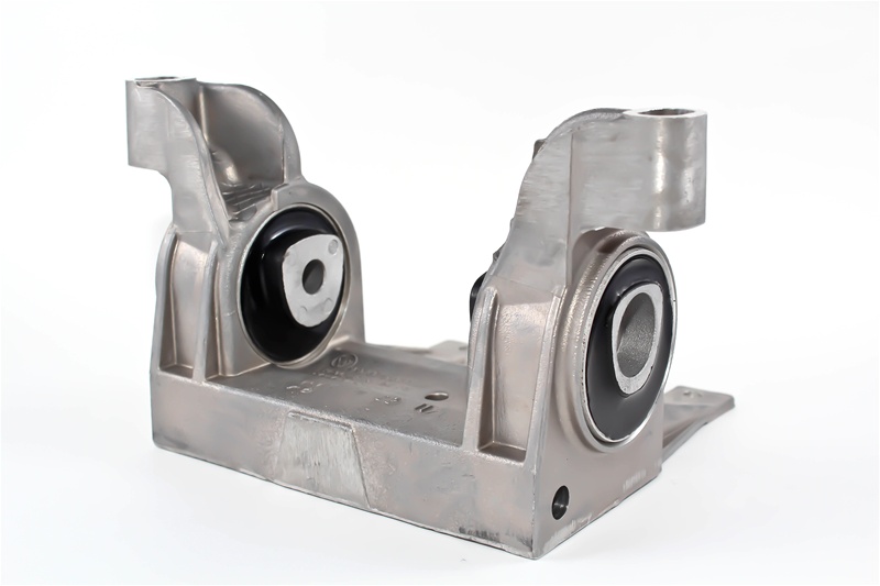

Torque Solutions Urethane Transmission mount review
I fitted torque solutions transmission mount a month or so ago, did it on 2 axle stands. Undertrays were fiddly doing it this way. about 1.5hrs start to finish.
Result:
*rear of car now very stable when changing direction and car settles straight away.
*Very positive to throttle inputs
*almost eliminated kangarooing when pulling away at slow/walking speeds
*very positive rifle like action to gear change and now 100% cured any 2-3 shift issues- now a perfect gear change!!:thumbup: Note: I already run cup cables, RSS engine mounts and Numeric Racings shifter.
*Some drone from engine- engine much loader in cabin by ~20%
Jay

Do you have a LT. Flywheel set up?
Because from what I know these mounts if paired with a LT. Flywheels set up the noise is more noticeable

if u fear noise, dont do any these mounts.
I have the solid mounts on my 964 and its really loud especially with the RS flywheel.
I guess on my 964 there is no interior which makes it loud as well

No LWFW... yet!

Mooty, are you aware of the new TS inserts in both 75A and 95A densities? Are these both problematic for noise as you state above?
no, either is fine.
i am talking about true solid mounts, metal on metal.
these hard urethane is great.
