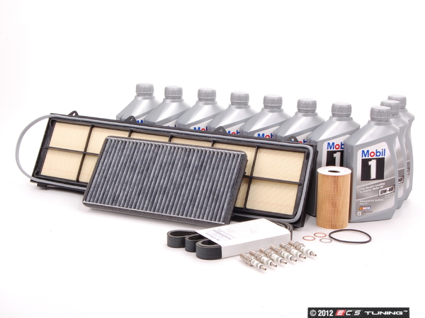

We offer a kit that includes everything you need for your next major maintenance interval. For more information Click Here
  • Mahle engine oil filter with rubber sealing ring
  • Crush washers for crankcase and oil tank drain plugs
  • 10 quarts of Mobil 1 0W-40 synthetic motor oil
  • Mann activated charcoal particle filter for the cabin air system
  • 6 Bosch spark plugs
  • Genuine Porsche air cleaner cartridge
  • Genuine Porsche serpentine belt

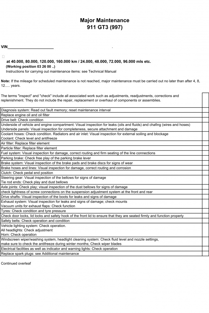

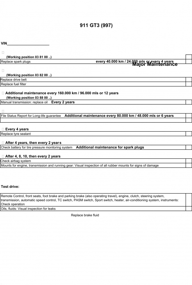

Here is the recommended service interval work from Porsche.

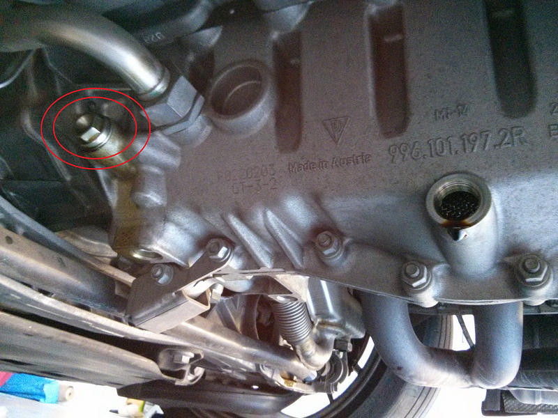

I just finished the oil change but by accident I loosened the bolt by the crankcase. Some oil came out by only a few drops. Does anybody know what it is?
