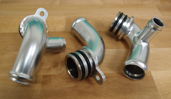

FYI guys... while you have your engines our we also discovered another nasty coolant pipe problem that can be addressed.
For GT3s:
http://www.sharkwerks.com/products.php?pid=386
For GT2's and Turbos:
http://sharkwerks.com/products.php?pid=394

This is a 997 GT3 problem and not applicable to the 6GT3 correct??
