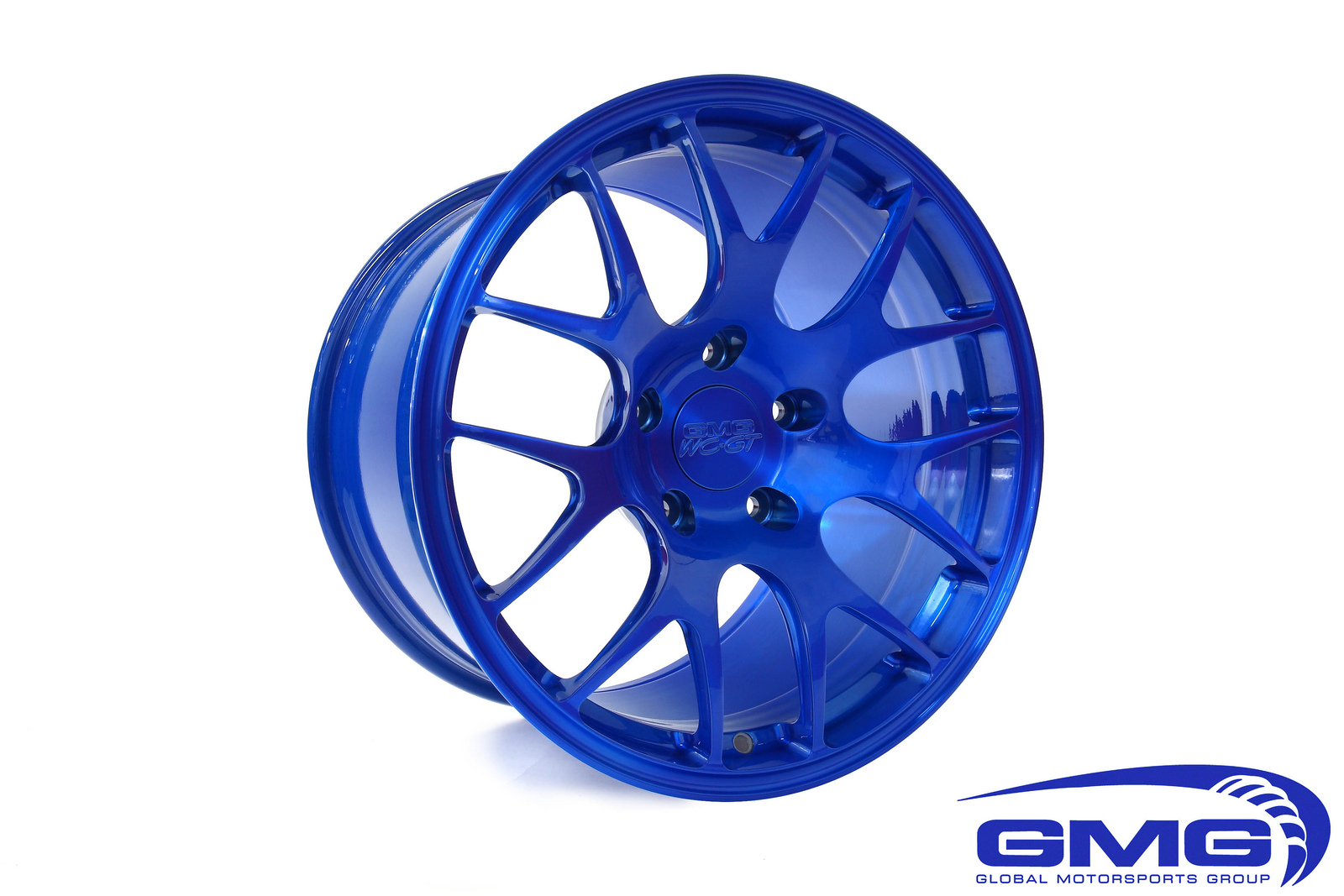

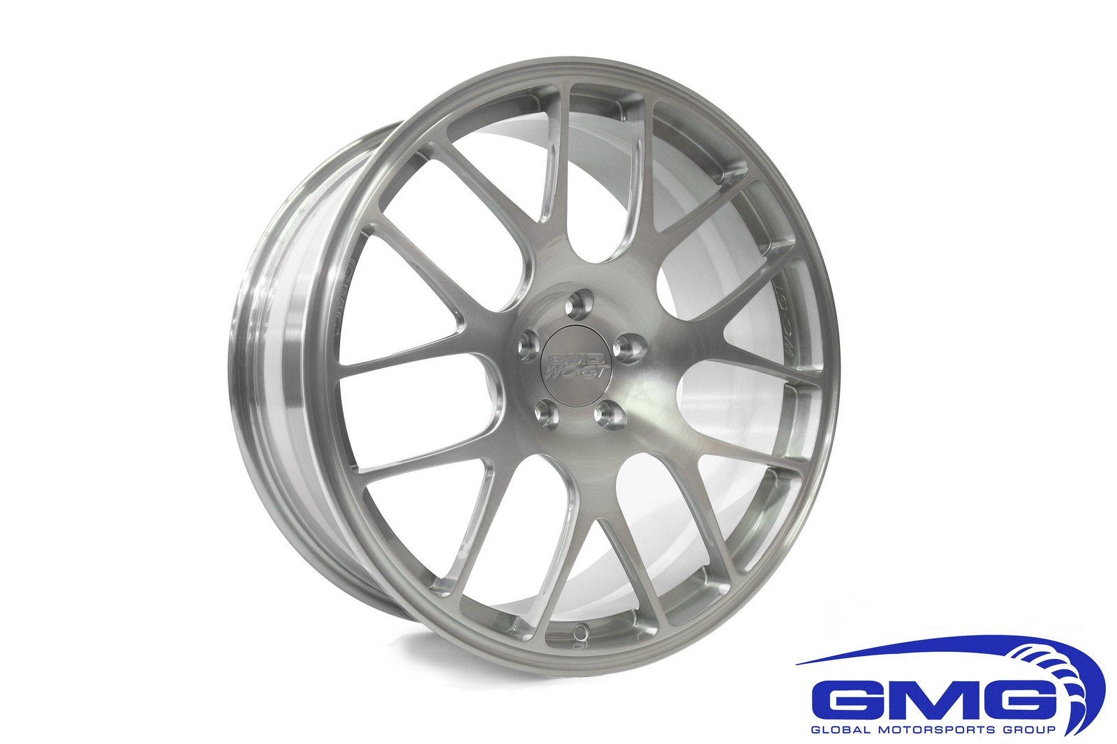

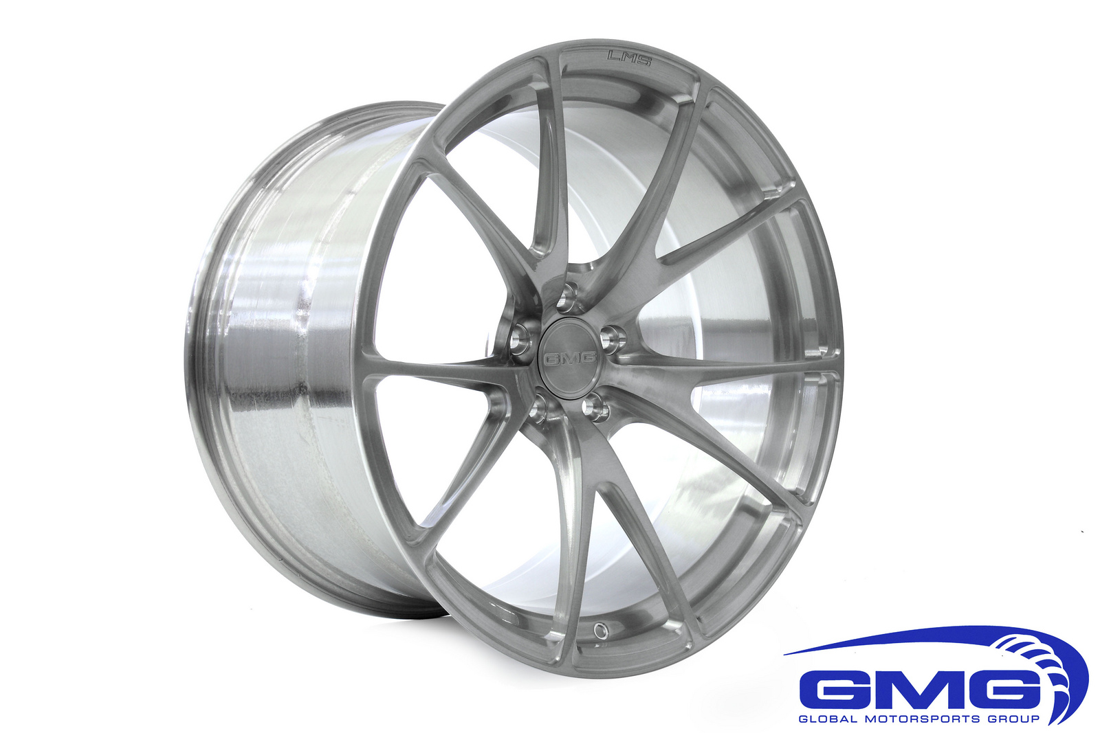

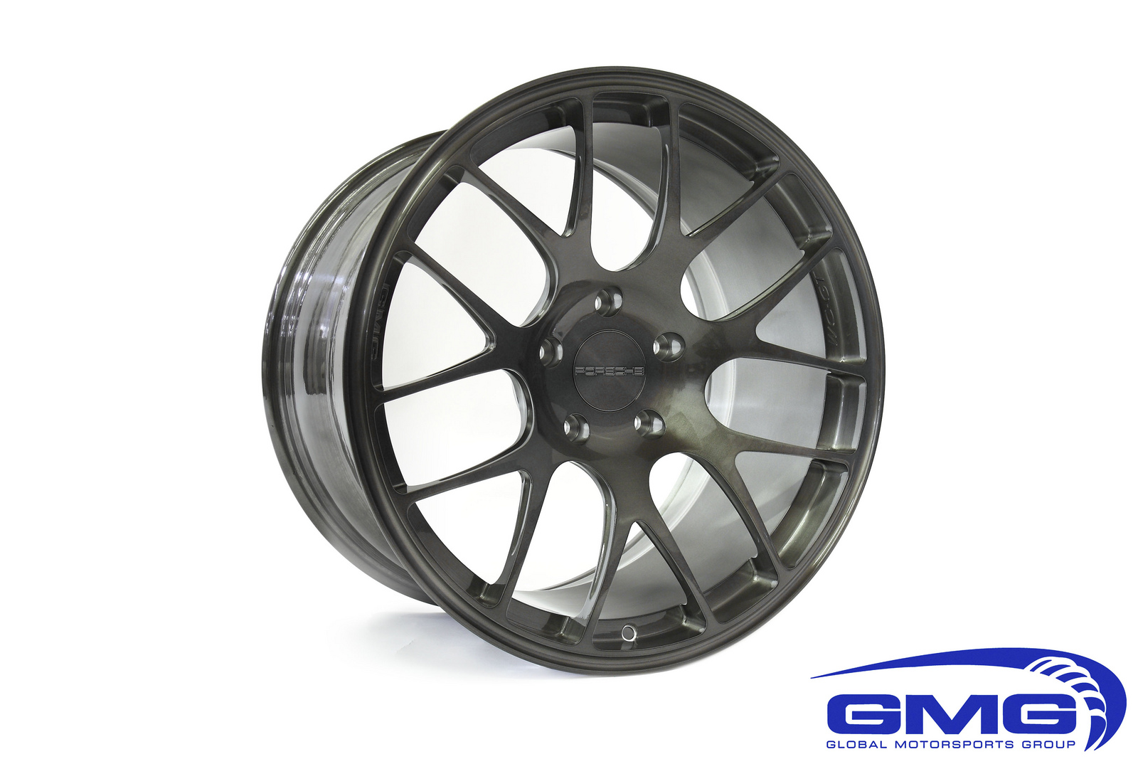

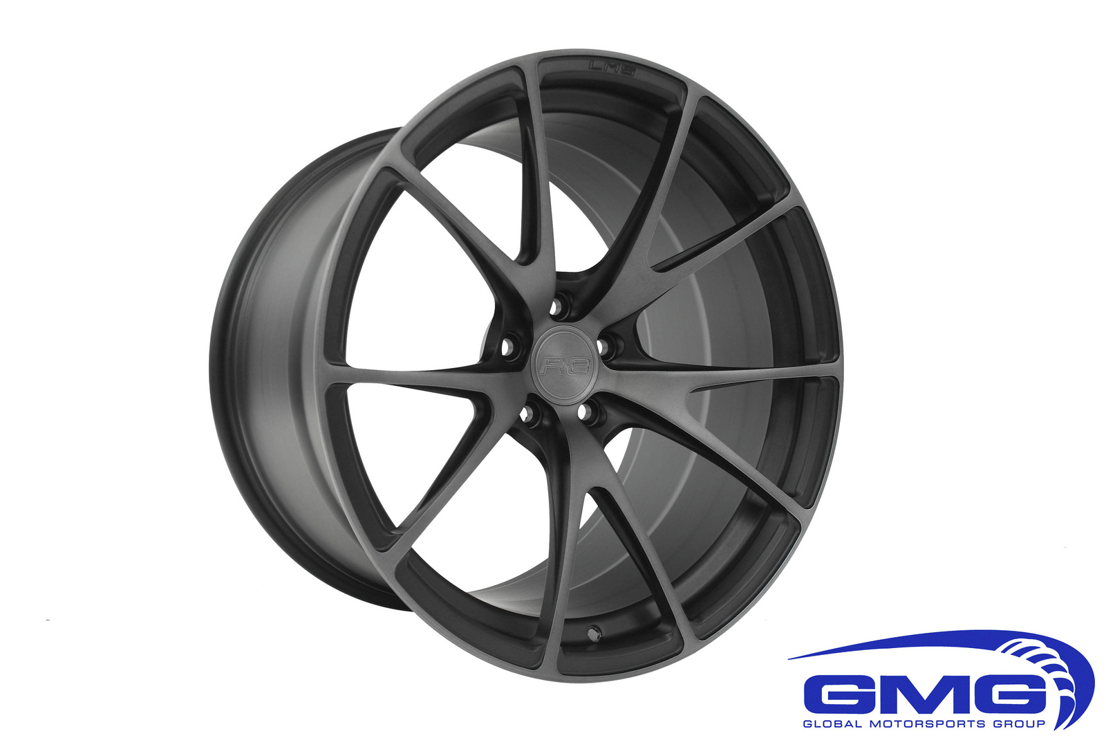

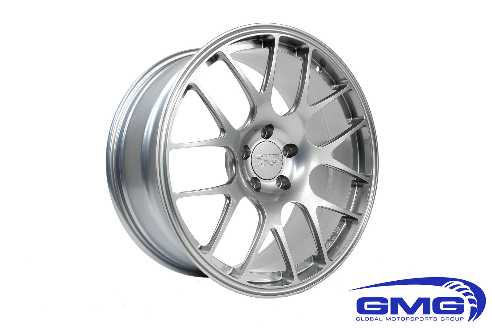

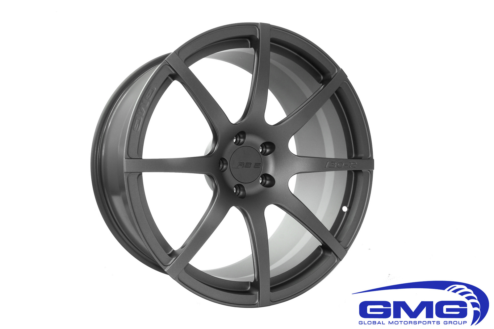

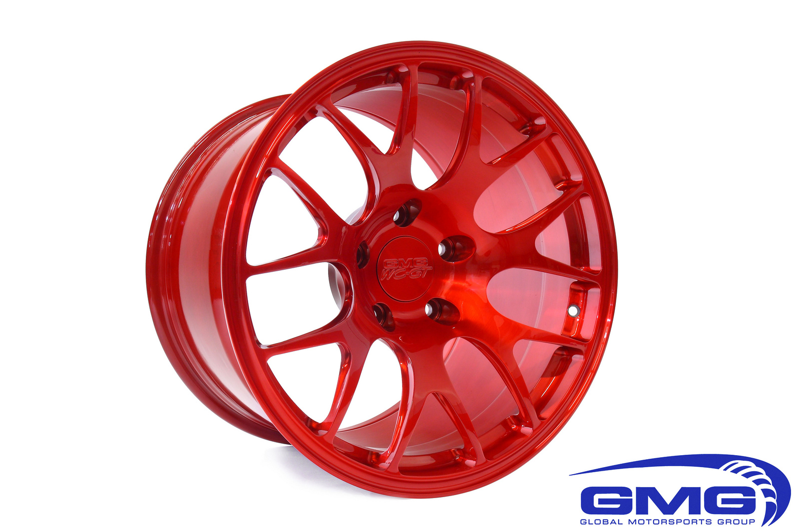

As far as the wheels go, I would go for 18x9 and 18x12 in narrow body GT3 offsets. Bang for the buck, CCW is hard to beat, forged, extremely tough, track proven, and fairly light. GMG makes beautiful super high quality wheels but they are in a different price category. CCWs are right at $3K anodized and a couple of hundred more if powder coated. I have sold several sets over the last couple of years and everyone has been very happy. Hope that helps.
Those wheels are absolutely stunning, I just don't know if I should go all out with the wheels too since I am sure everyone knows how much just the brakes have been thus far haha!! A virtually new/used set of PCCB from a GEN is pricey.
Just hoping that if someone has any of these specific wheels for sale that will fit my 6GT3 let me know ASAP. I would prefer a used set however will more than likely go new if none can be found.
