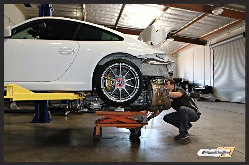

Planning on doing more and more track days with GSR, our customer was constantly haunted by the specter of an eventual Mezger GT1 Coolant Pipe Failure. Simply put, coolant dumping on the rear tires = a very bad day!
Despite his car being very low mile, he had done enough research on documented cases to make him rather uneasy (Thanks Internet)! It seemed that the coolant pipe replacement process was becoming the norm for GT2, GT3 and Turbo Cars with Mezger Engines. This is arguably the only ***** in the armor of the legendary Mezger GT1 Engine. Interestingly enough, Porsche Motorsport is still running variants of this engine in the 991 GT3 Cup and 991 RSR.
With these thoughts looming in the back of his mind, he was convinced he would not be able to focus on developing his driver skills/race craft until he put the ghost of the GT1 Coolant Pipe Issue to rest once and for all! After all, it’s safety first, right? He decided to proactively bring the car to GSR Autosport to address the issue and get what he so desperately need… piece of mind.

Thanks to Sharkwerks for making the fix relatively painless. In addition to pinning several critical hoses in place, the GT3 coolant pipe fix replaces 2 plastic o-ringed elbows (problematic) with some very nice stainless steel o-ringed replacements.
To find out more about the overall procedure feel free to give us a call or check out Sharkwerks Technical Article and video!
