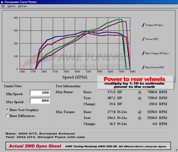

I was looking at the GT3 dyno chart on the Europipe website. That motor has a pretty sharp upward power curve from 2800 thru 7200 rpm's.

Re: Question on GT3
Originally posted by cjv
I have a question for those with a GT3.
My question is at what rpm is your sweet spot? Or putting it another way ........... at approximately what rpm does your torque and power start to come on and approximately where does it start to taper off?
The reason for my question is KA's new turbo motor is utilizing the GT3 cams. I'm trying to determine which type of turbo's would best serve tracking/driveability purposes.
dyno chart

Re: Re: Question on GT3
Originally posted by rockitman
dyno chart
Looks like 7300-7500 rpm's is all you really need.
