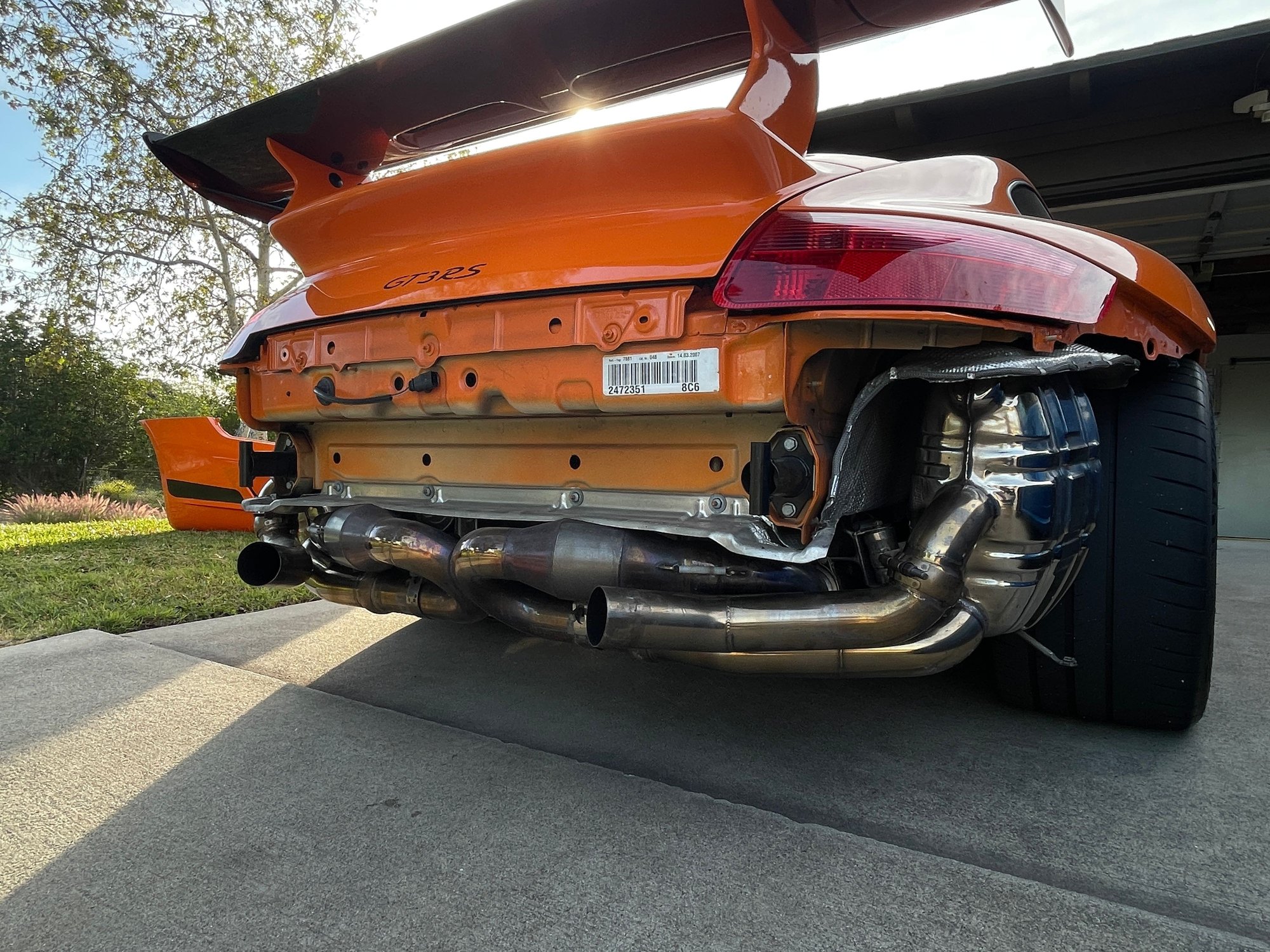

No valves, sound was traditional flat 6 sound but in a deeper tone. It screamed but wasn't as loud as stock side mufflers with a center delete. One the course of my several GT3 cars, I've run:
1. Bone stock
2. Stock headers and RSS center delete - this setup beats the Sharkwerks out of the water.
3. Stock headers and Sharkwerks center delete - sounds good but begins to lose the scream up top. The RSS keeps getting crazier and if I had to do a center delete, it would be the RSShands down. Both of the center deletes drone a wee bit but it's not something that will bother you.

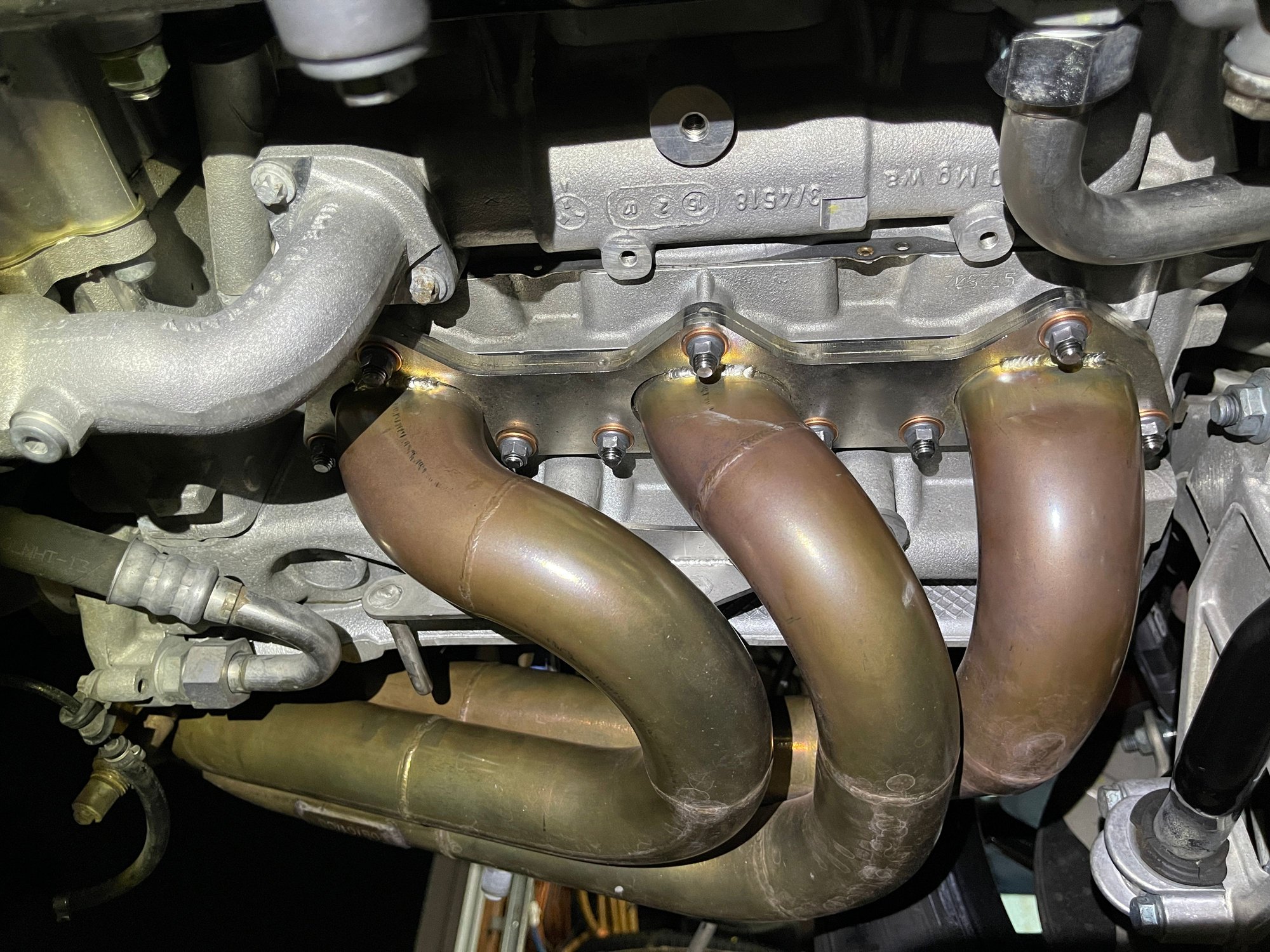

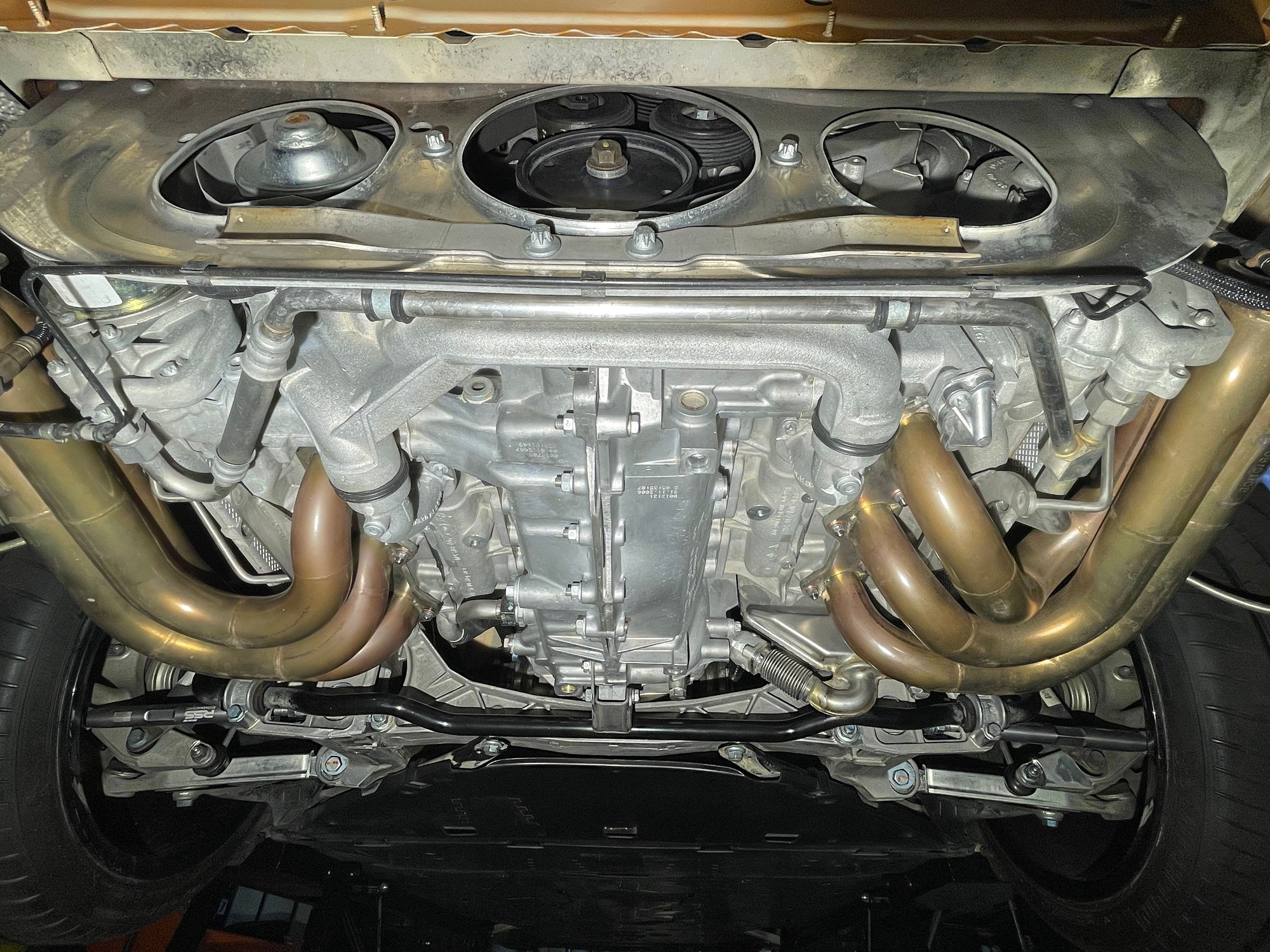

4. Full FVD, Brombacher, M&M set up. Long tube headers and 200 cell cats. this system in its factory form gives you a flat 6 sound, something that is lost with a center delete. I know this because I removed the center delete for this system on two different cars. Love the flat 6 sound but it was just deeper in tone and not really louder. I then sent the system to Gert at Carnewal in Germany and he modified it to be quiet on the streets and a screamer in the canyons. It's crazy now and can still sound deep and like a flat 6 on the streets. It's the best of both worlds.

oh yea, I forgot the 996 doesn’t have that center exit. Keep in mind that unless you specify, any exhaust coming out of Europe will be naturally quiet to start as they have strict sound ordinances. When I removed my center delete and installed the Brombacher it made the car incredibly quiet. I drove with that exhaust for years and loved it. Then I wanted something louder and Gert got me sorted. Had to ship the system to Germany and wait it out.
