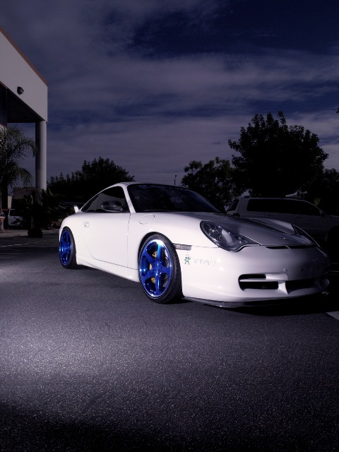

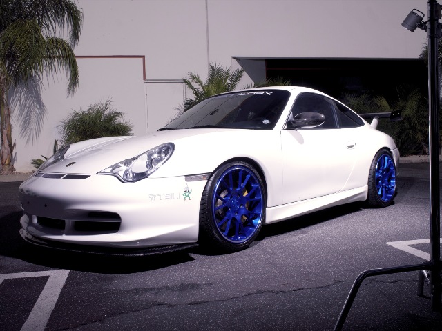

I totally disagree!!!!
The GT3 is fine to run 19"s I tracked mine for a year with 19" wheels the only thing you give up is R compound tires. I build these two style light weight 19" wheels. The front 19x8.5 weigh 19lbs and the rear 19x11 weigh 22lbs compared to stock wheels 18x8.5 @ 25lbs and 18x11 @ 27lbs. Thats a 32lbs weight reduction in unsprung weight and then multiply for rotatiing mass.
So the big thing is GT3 purest feel 19's are a sin, do not listen to them as long as you are not increasing your weight from stock your performance will be fine and you already have 18's for the track so go ahead and run 19" I can give you the offsets so you don't rub and if you want to go aggressive I can tell you those offsets as well.
As stated before the overall diameter will stay the same if you use the correct tire sizes.
19x8.5 front +41mm 235/35/19
19x11 rear +55 - +58mm 315/25/19
19x11 rear @ +51mm is very aggressive and you will need to roll the fender just about flat but they will work as well.
Yes you can run 315's on a narrow body no problem.( Just not Michelin as they have a very square and blocky side wall)
Use Conti, Yokohama AVS Sport if you can find them or Toyo now has thes sizes in the T1R.
GOOD LUCK GO FOR IT!!!!!
