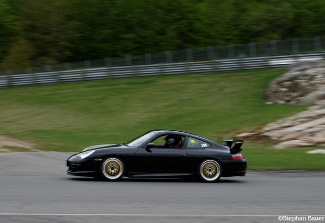

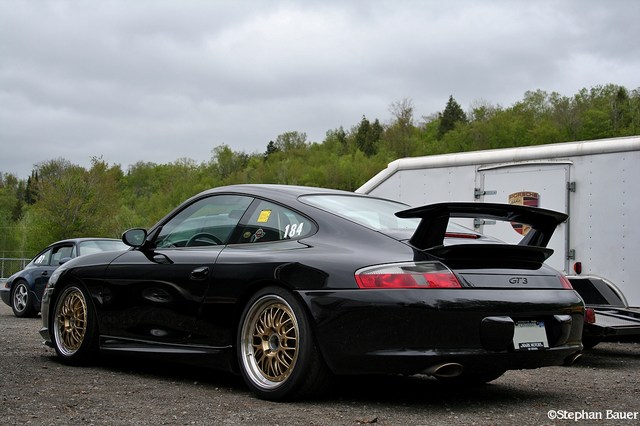

There are other options for 18"s for the GT3. There is absolutely no good advantage to a 19" on a GT3 besides bling. 18" bling works for me. Like these BBS.
Nice golde wheels man, you moving on up, to the top, to a deluxe appt in the skyyyyyyyy??
Nah dude, those are not mine. (Just pics I had on my comp). They are the wheels I am going to get. Mine will be black though.
