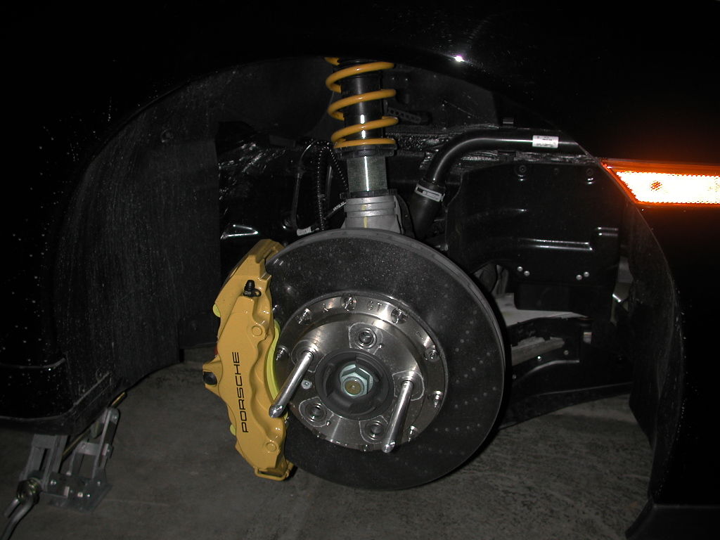

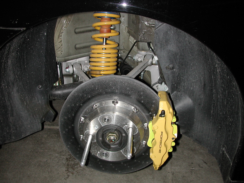

Pictures of my car...
You can see the edge of the H&R logo

I will post the part numbers for 2003 and/or 2004 tonight, as I have them at home. However as you can see from Josh's photos the springs are progressive.

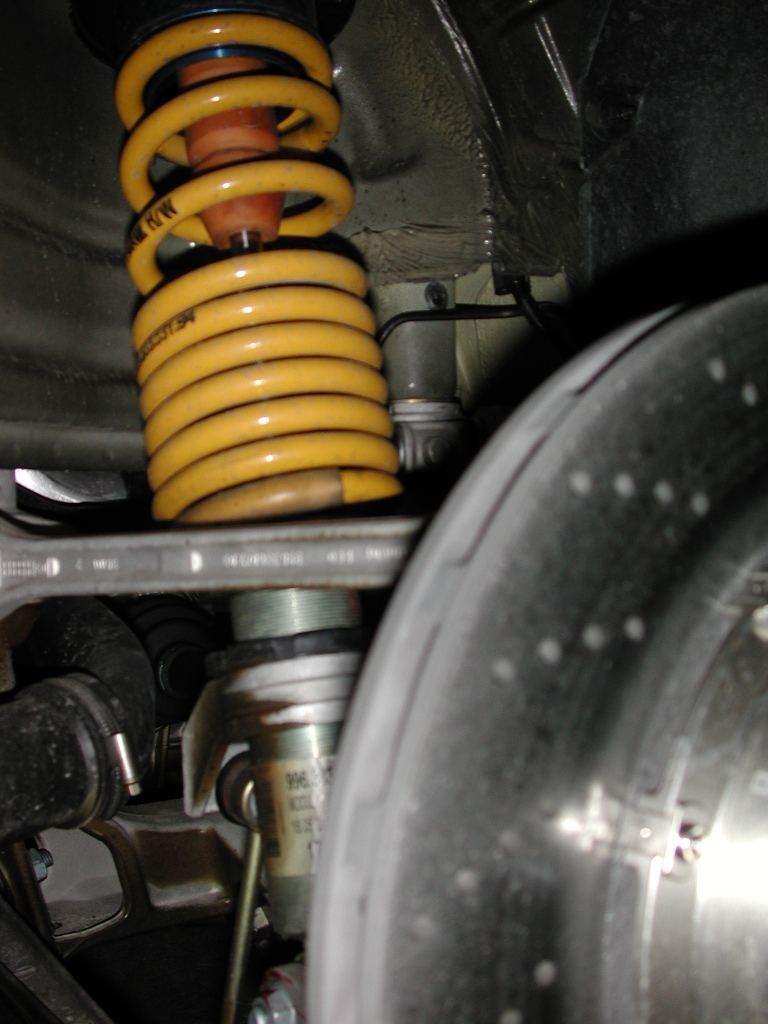

Just to clarify, see picture #3, the previous owner had the collar turned all the way to the top so the car has that bling bling ground hugging look that bottoms out on uneven LA freeways for no techincal reason.
I turned it down to around where picture #3 collar is. There still appear to be a lot of travel on the coilover that can be made if it wasn't for the length of the spring.
