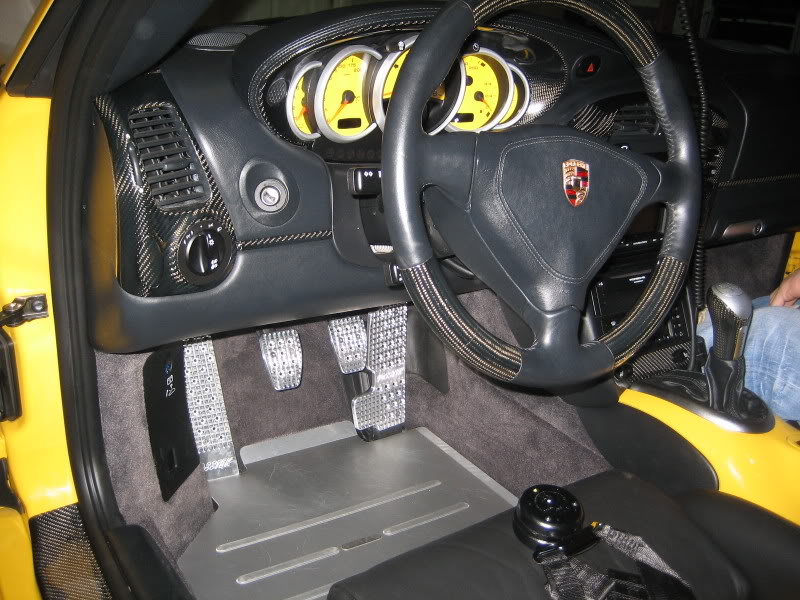

Originally Posted by tom kerr
heel toe is really a misnomer. your second choice is closer to the best. It is really toe toe. the ball of your foot is on the right side of the brake. under threshold braking (why doesnt really work on the street) you "roll" your foot over to the gas pedal (which at that point should be at the same height) to "blip" the throttle
also aftermarket pedals can help
Yep. What he said.

I had aftermarket (Vosstech) pedals before, they look just like the ones in the yellow car that mr. kerr has posted a picrure of.
I installed the Rennline adjustable pedal earlier this year, and found heel-toe much easier to do with the Rennline pedal. In my case the throttle is now higher up compared to stock with the aftermarket pedal mounted on top, and this makes it easier for me to blip the throttle when using the brake.
I use the outside edge of my foot on the throttle, not my heel.

I roll my foot when on the track, but can only reliably do this with Rennline pedal extensions. On hard braking both pedals seem to be at the same elevation, so no adjustable elevation needed.

I tend to use the left portion of my foot for the brake (a big left portion) and the remaining for the throttle - but my leg is a bit oddly shaped due to too many knee surgeries. I suggest that you experiment where it is safe...
There are pedal 'supersizers' if you want for the brake pedal and throttle and they frequently have anti-slip bits on the to help. I have in the past moved pedals around a bit to make it work better as well...
