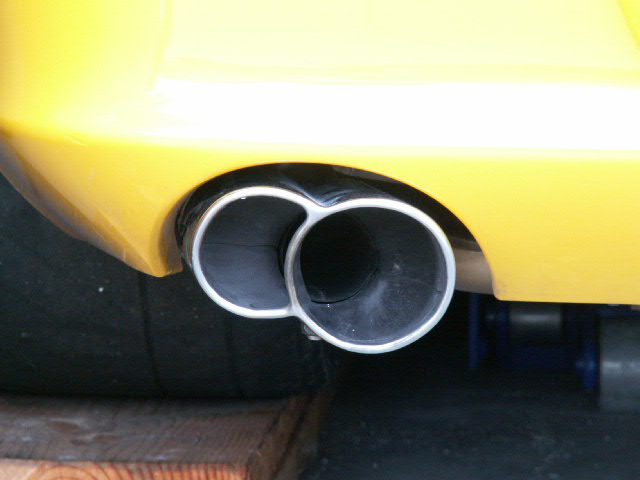

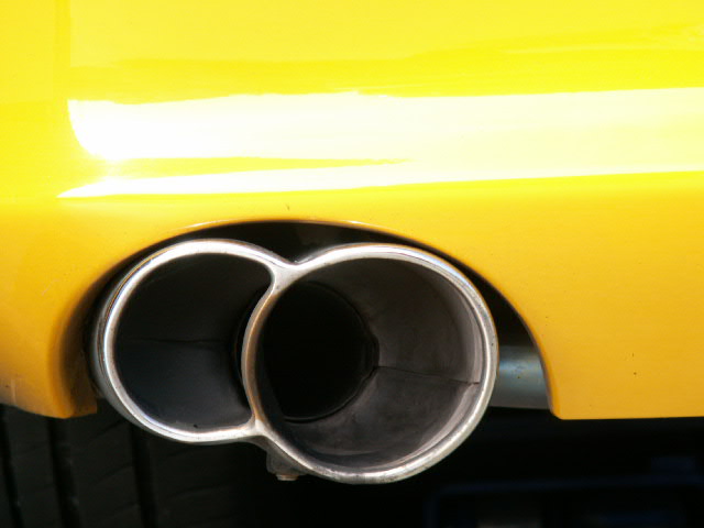

So, I installed the WEVO motor mounts on my '04 GT3. I would have thought that the engine would have dropped a bit, but looks like it was raised. See the positioning of my muffler tips to see the change. Was this to be expected?

I don't know that it was supposed to lower the motor, maybe that was wishful thinking on my part, lower the center of gravity, that is. Nonetheless, I've been in communication with WEVO and Joel Reiser of PCA Tech. IMO, not good news for using the WEVO product on the 996GT3.
WEVO tels me their C2 SS mounts were not designed as replacement parts for any car later than the 993, and that they have never done an install to be able to validate correct fit for any other model.
However, as LVDell points out -
Check out this link from THEIR website:http://www.wevo.com/Products/Chassis...gineMounts.htm
It specifically states:
The C2 SS mount can also be used on the 996 series chassis and the 996 based GT3 cars – however – a longer bolt is required than the unit provided with the kit.
PCA Tech -
That does not sound right. How much have they come up? If it's an eighth of an inch, I wouldn't worry about it. If it's a half an inch, let's figure this out. My guess is that the bottom of the Wevo mount might be sticking down into the large square opening of the engine mounting crossbar. I would repeat the installation, this time putting in a large thick strong washer on top of the crossbar, just below each motor mount. They don't have to be metric, although that is preferred. Let us know what you find.

Already did that, especially since his shop is about 15 miles away. See my note above that WEVO (Hayden) disclaims any use other than for 993 even though their site cites 996. He is a nice guy about it, but essentially says I'm using the part in a manner for which it's not designed. According to him, my only recourse is to TRG who sold me the part. Hoping to hear from Austin.

My bad. It appears I misassembled/misinstalled the WEVO mounts. The kit comes with a bolt, a washer and a nut. I used the washer with the nut on the underside of the mounting crossbar. WEVO has advised me that the flat washer supplied should be placed immediately against the lower pillow above the crossbar. This was not clear to me, apparently.
