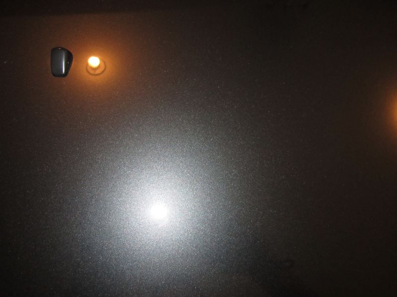

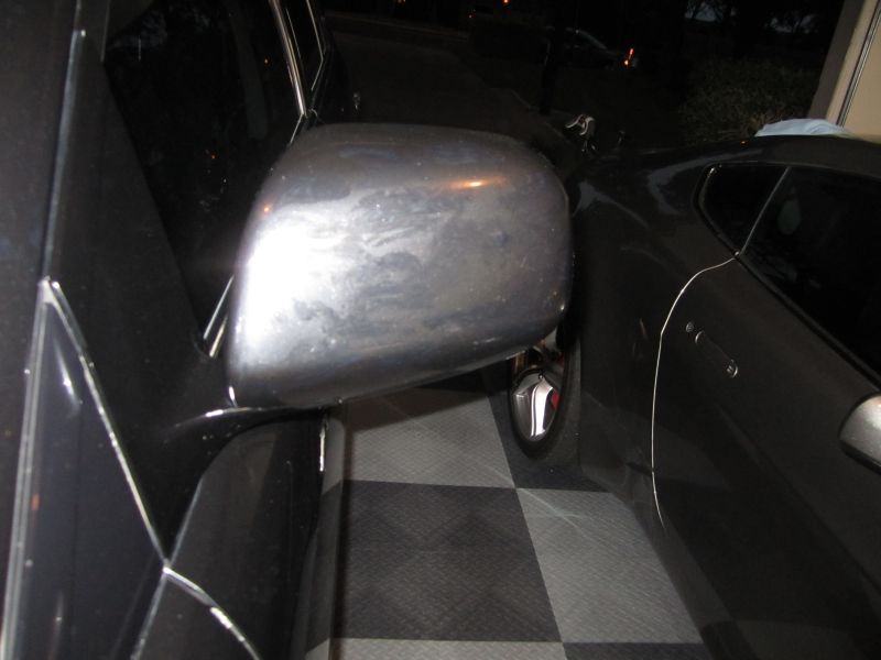

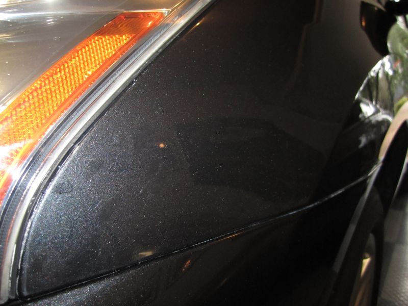

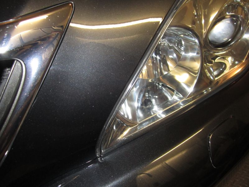

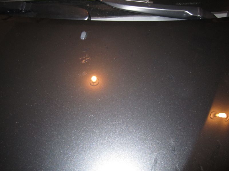

I let each section dry for about 20-30 minutes. They recommend between 2 mins and 2 hours. I found that if you wait too long it becomes harder to get the excess paint off. Closer to 2 minutes and the paint may not "hold" in the rock chip.
After 20 minutes passed, I grabbed the sealact blending solution provided and poured some on an old tee shirt. After light rubbing you can literally see the paint blend in, amazing! Immediatly after I wiped with the provided microfiber cloth.

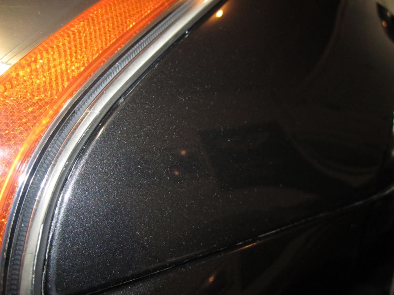

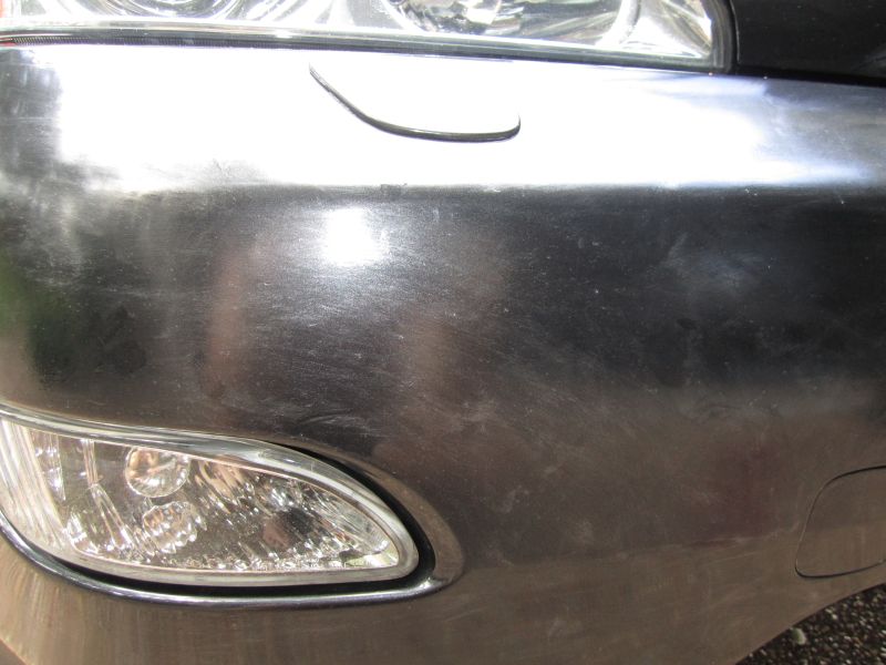

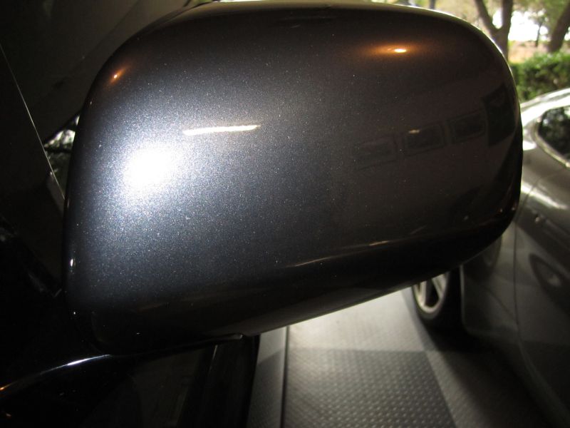

After wiping with the microfiber cloth I was amazed when I stepped back and looked at the results.

The road rash "think hundreds of small chips" is entirely removed. The larger rock chips are still visible up close but are the color of the car without the "blobs" you get with using touch up paint. My only concern with that is will wax fill in those crevaces.
If you step back two feet, the car looks brand new. The pictures I took were with the flash on and show all imperfections. It looks better in natural light!
In summary, I will be getting some for my Aston Martin and rate it an 8.5/10.
