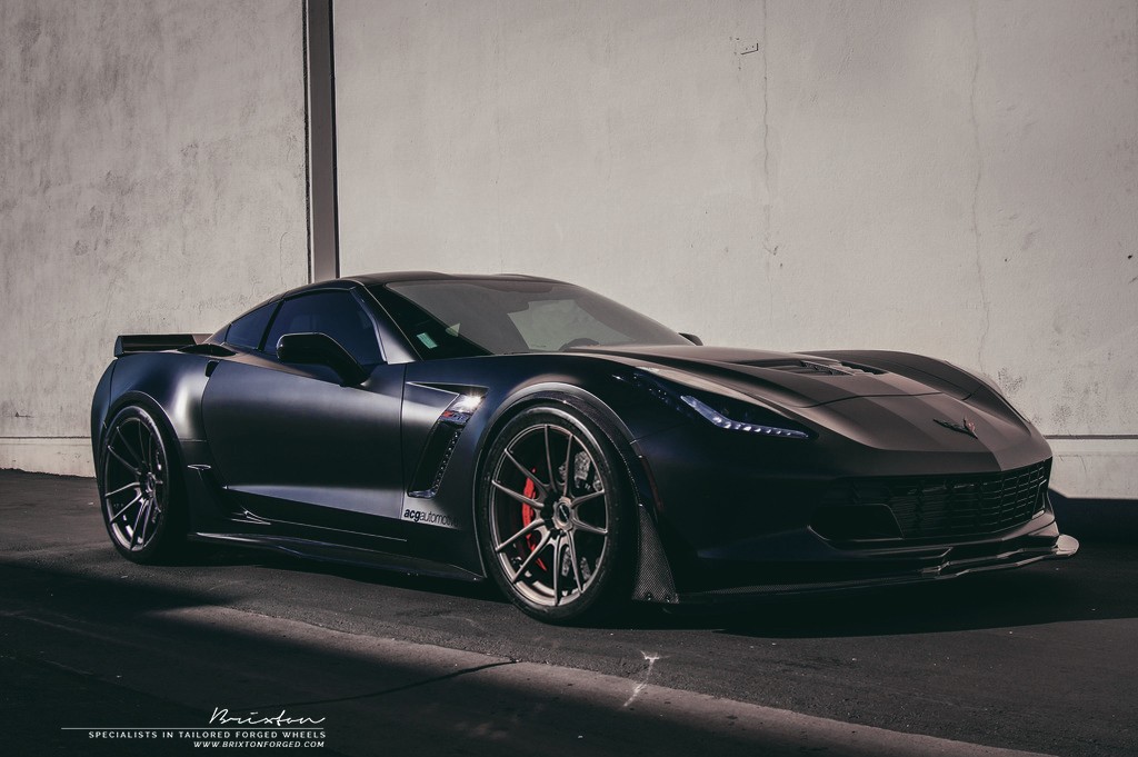

I think you need to get yourself a Z06
Save a lot of time, money and headache AND get a hell of a lot more HP.
