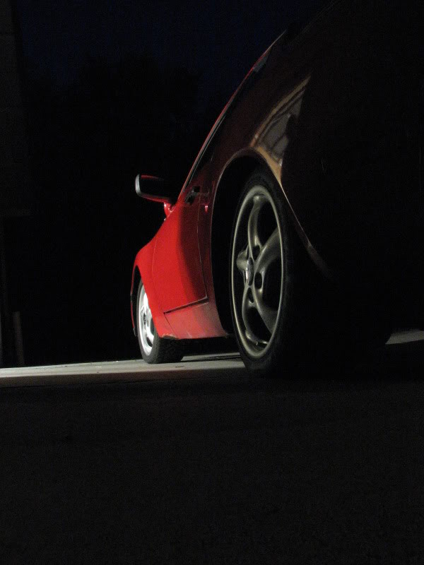

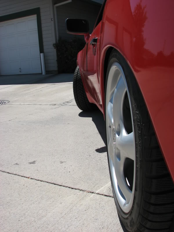

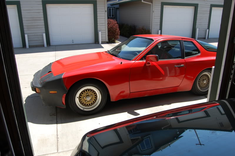

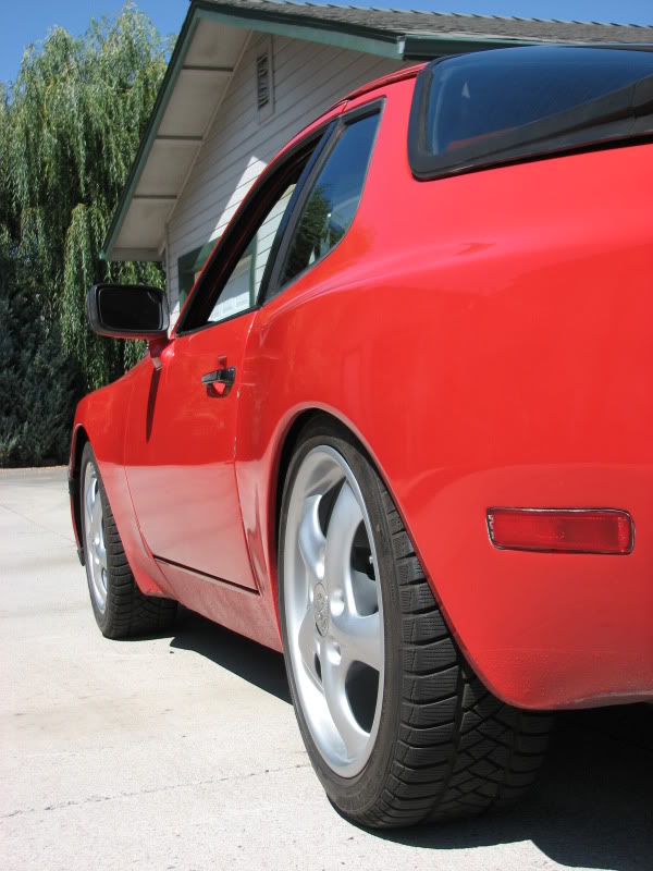

Some visuals... without spacers. Now, i've used a couple spacers from the stock ones to try and push them out, looked "better", and they don't rub. In fact, the car actually sits LOWER and has a bit more clearance because the tire profile is so low, compared to the others.

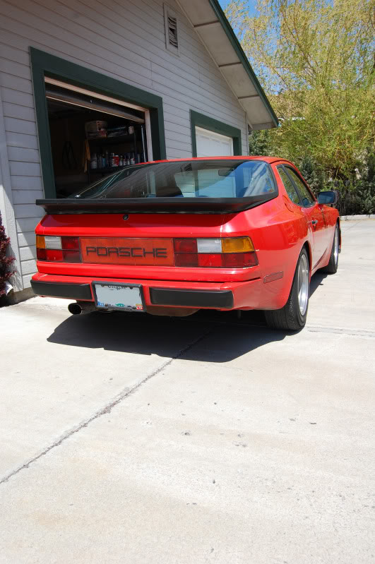

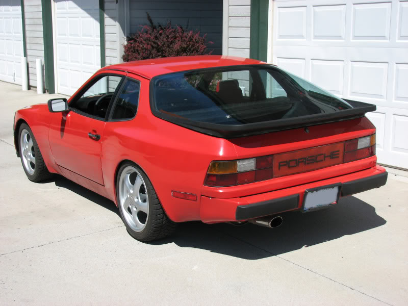

The other wheels:

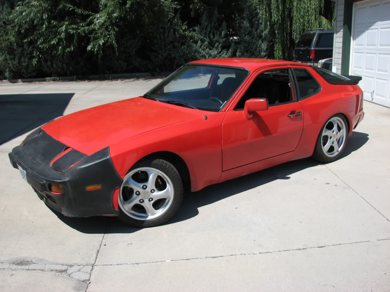

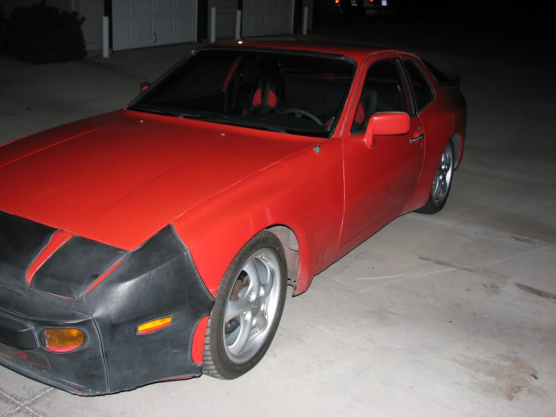

I do want to take a moment and thank Alan because he knows his stuff, and if not for him, I'd for sure have ended up with the wrong stuff. I put them on today and fitted the wheels and was in awe at how closely they fit, and how well they fit. I ended up going 43mm rear, 33mm front. The pics speak for themselves. I know where I WILL be going for the future, Alan impressed me with how QUICK he figured out everything, helpful and was nice enough to talk to me over the phone about it. No one else had offered that and explained it to me, and it made sense. So thank you.
