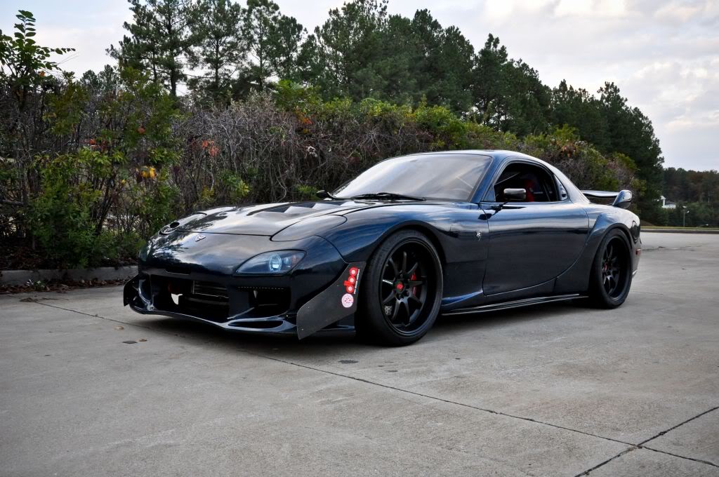

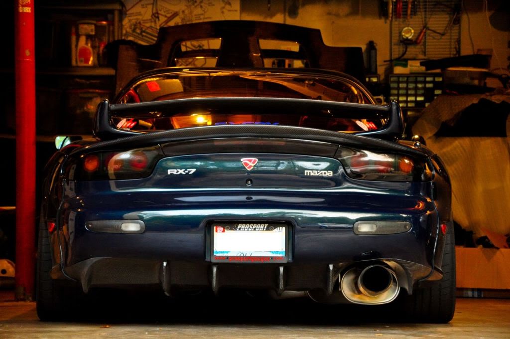

Since I posted pics of my Cosmo, I thought I also share my other Rotary cars.
Will post some specs to the car later... as its getting kind of late for me.

not feelin that front end.........but everything else look great.......how wide are those fronts? looks pretty beefy

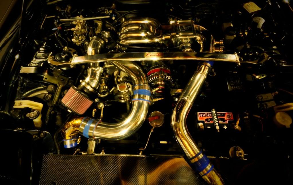

Couple of pics..
Mod list
Engine:
-Petite Polished AST
-Koyo N-Flow Radiator
-Custom Carbon Fiber Cooling panel
-Fast acting Airtemp sensor
-Remote Start/pager/alarm/turbo timer
-BNR Stage 3 Twin Turbos
-Ported 13B-REW engine
-Custom Grounding kit
-polished Efini-Y pipe
-Polished upper intake manifold
-Polished 90mm Rotary Works Throttle body
-Polished Greddy elbow w/injector ports
-Apexi GT Spec FMIC
-Custom polished pipings By: BNRSupercars.com
-Constant tension T-blot clamps for IC pipings and Intakes.
-HKS seq. BOV
-HKS twinpower ignition amp
-Tanabe Catback
-SS Petit DP
-Apexi PowerFC
-Racing beat ignition wires
-FEED oil filler cap
-FEED coolant filler cap
-Added R1 Dual oil coolers
-Braille light battery
-Braille Verticle mounting kit
-FC Datalogit
-Unorthodox Alternator pulley (red)
-Unorthodox Power steering pulley(blue)
-Exedy Hyper Single Clutch Kit
-Simplified seq twin set up
-polished hardline intake pipes for secondary intake.
-Ported JDM Upper Intake manifold and polished by David Garfinkle. Also all the misc. vacuum ports have been welded shut and clean up and polished for cleaner look.
-Pettit Racing water pump pulley
-2 x 4 blade fan set up for better cooling
-HKS RS intake with KN filters
-Tweakit Racing tensioner pulley kit
Suspension:
-M2 launch kit
-Coilovers (About to install FEED coilovers)
-Racing Beat sway bar brace
-Racing Beat sway bars (front and rear)
-Garfinkle Motorworks Engine torque brace
-FEED front strut tower brace
-RZ larger front and rear brake calipers
-Hawk HP+ pads front and rear
-Newly sandblasted A-arms and other suspension parts
-Custom Garfinkle Motorwork cross drilled RZ rotors
-Braided SS brake lines
-Racing Beat sway bushings
-New Delrin bushings for all suspension parts
-Transmission brace
-Dragon's diff brace
-WORK XD9 18x10 +38 with 15mm spacer front and 20mm spacer rear
-Michelin PS2 255/35 front 295/30 rear
-Raceshop rollbar with much stronger rear strut tower brace.
Interior & Stereo:
-Converted Black interior - including, door panels, rear panels, head liner, seat belts, and black main carpet
-RZ floormats
-Rare moon roof interior cover
-JDM rear seats with panels, seat belts, and special rear carpet
-added R1 rear speaker pods for 7 speaker system
-Prosport boost, A/F, Fuel, Oil temp gauges
-Prosport center speaker pod
-Bride Exas III seats with Bride rails
-Nardi shift ****
-red leather stitching shift and ebrake boots
-LED interior lights
-Rare red stitch Nardi wheels
-Custom install of Protege cruise control to the Nardi wheel
-RE steering column pod with 52mm Prosport boost gauge
-JKL Engineering Carbon Fiber Gauge cluster, hood AC panel, shifter,etc (not overlay)
-JVC 7inch AV system
-New EL PowerFC commander and holder
-RE-A speedo cluster gauge
-FEED Carbon fiber rear trunk add on.
-Base model hatch cover
-added OEM fog light switch to turn FEED HID driving lights
Exterior:
-One off Feed Carbon Gas door (Shine Auto)
-Feed Type 2R front bumper
-Feed Carbon fiber canards
-Feed Carbon Fiber side skirts
-Feed wide front fenders
-FEED rear wide flares
-RE-A Carbon Fiber N1 hood
-Rotary Extreme hood dampers
-R-magic oil cooler ducts
-FEED front tow hook
-RE-Amemiya Carbon rear diffuser
-99 rear spoiler base
-AutoEXE carbon fiber rear spoiler deck
-MS replica 99 undertray
-Custom LED tail lights
-Odula carbon fiber 99 spoiler covers
-Custom rear bumper CF covers
-FEED head light cover
-rare glass moon roof
-SportTuner HID projector head lights
-LED signal lights in FEED signals
-HID FEED Signal lights
-Spirit R fender badges
-Efini front are rear badges
-Carbon look rear bumper lights
-Carbon fiber FEED gas door (one off made)
-APR Carbon Fiber side Mirrors
-Custom front canard add on
-Carbon Cooling panel (custom, made by me)
-LED bumper strip
-FEED signal light covers
-FEED door handles
-Carbon back of the door handle covers.
-Back Off 3rd light flasher
-ShineAuto rear tail light lip
-Feed bumper guard
-Custom rear tail lights

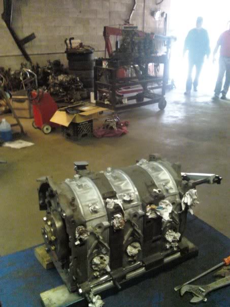

Originally Posted by casper
tell me you have a three rotor in here!!! i wanna see!

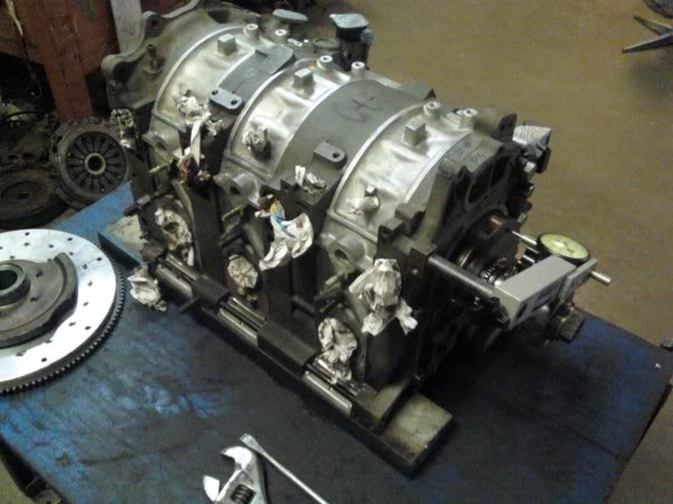

Not yet...
But I have a D series motor completely built with all the mounting hardwares and such... I'm currently researching about the injectors and ECUs.
Here are couple of pics of the built motor.

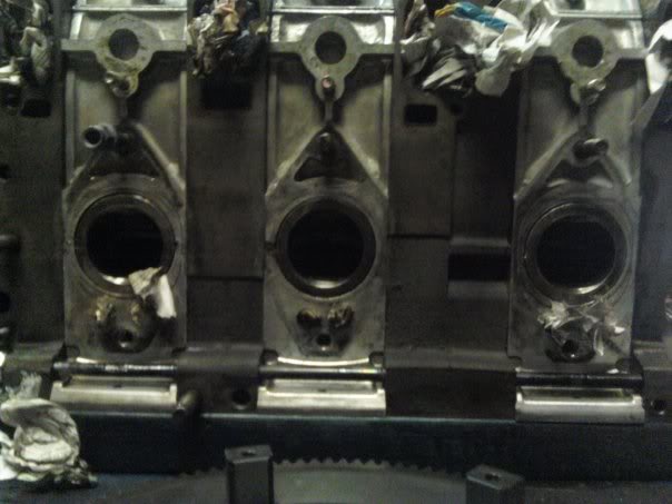

Modified exhaust sleeves with 13B REW sleeves.
Perfect spec as motor had very little miles

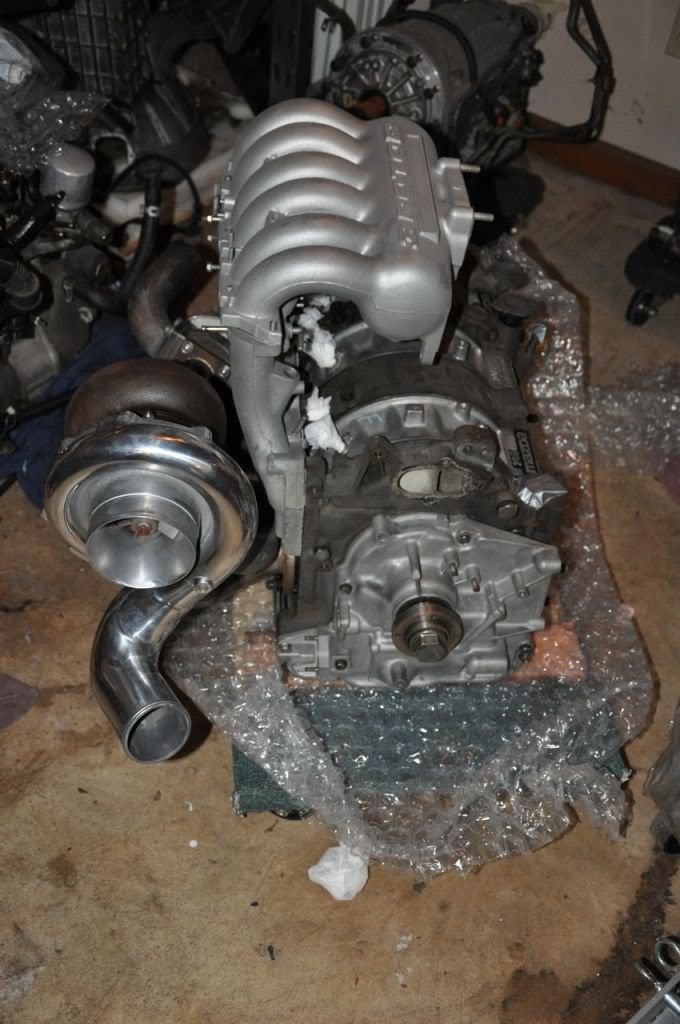

Test fitting the turbo, LIM, and UIM... Making sure of its fitment.
20B project should be done sometime mid 2011.

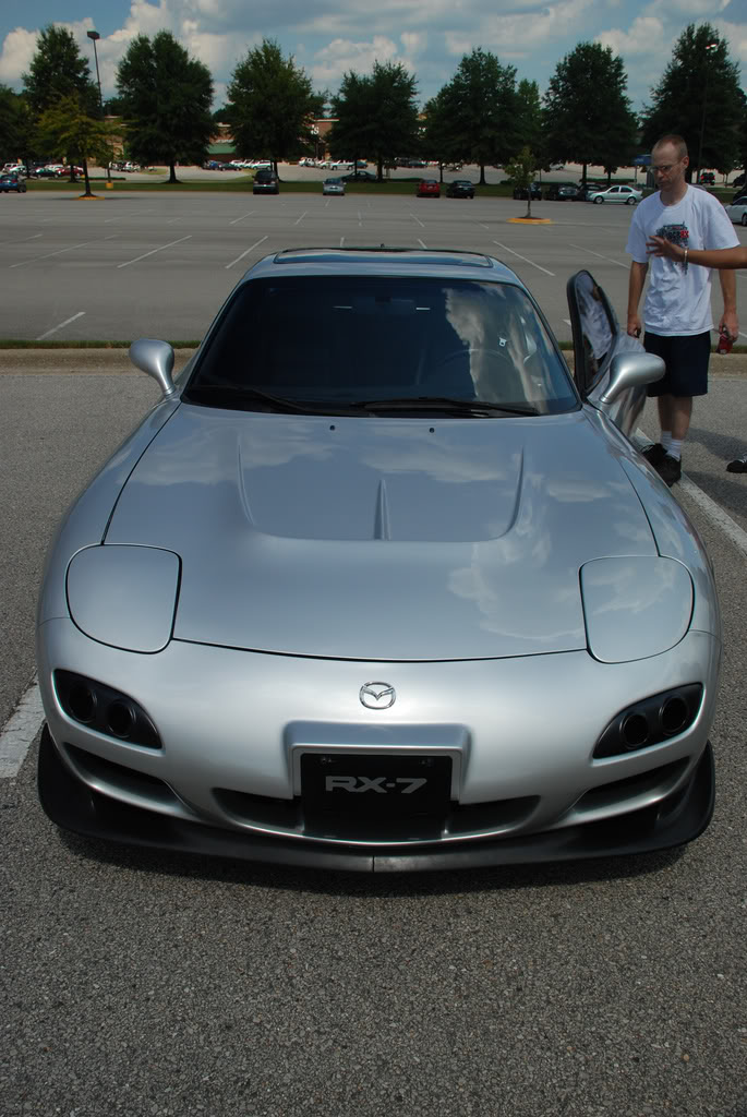

I hear ya... Its not everyone's cup of tea. I have new front being worked on and also I have another FD that's more for purists..
94 SSM with about 32.5K original miles. I've been collecting rare Mazdaspeed and Mazda parts to go in this thing.. Some parts only handful of us here in the states have.

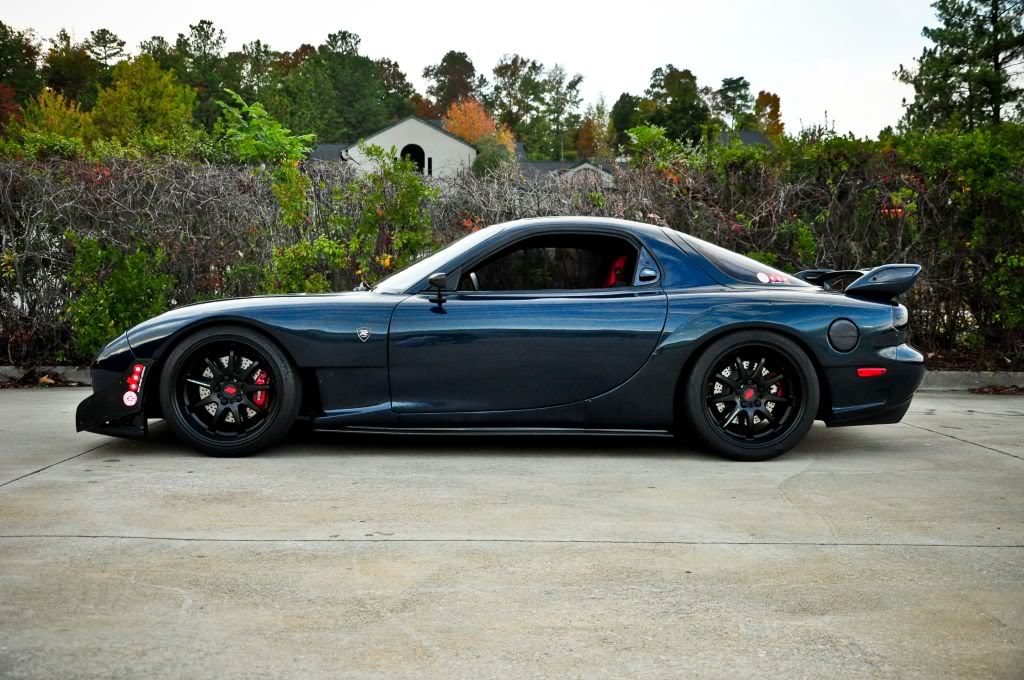

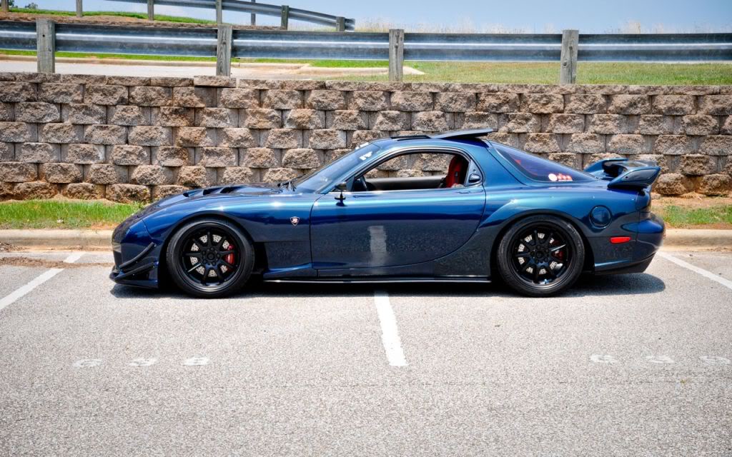

Are you asking the fenders or wheels?
Fenders are FEED, which are I believe 20mm wider.
Wheels are WORK XD9 18x10 +38 w/15mm spacers to clear the calipers.

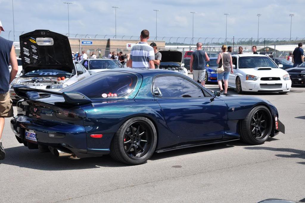

Couple of more pics..
At a regional event after car was detailed and went through 4 hours of rain... Sealant and wax really worked!
Just after I got the wheels on..

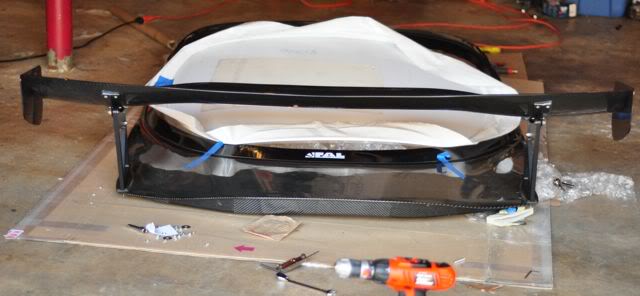

Originally Posted by gnx7
sick FD. Going 3 rotor.... can't talk you into an LSx setup
Some day I'll do an LSx swap or pick up a new vette...
Anyhow, the car will go through another exterior change next year..
hint:
