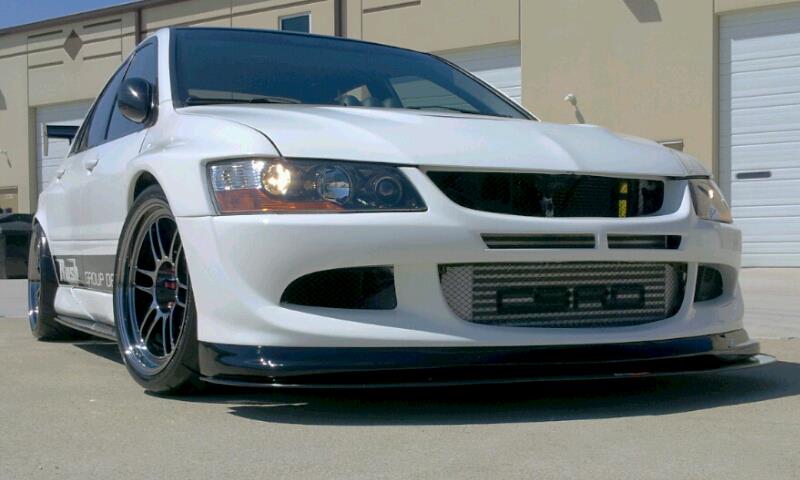

HERE IS FROM TODAY
Prototype CBRD BBK-C I tested. Made 470whp on a Mustang Dyno. Was able to hit 20psi at 2700 in fourth gear on the street. Zero lag on the road course.
She hasn't been driven since it's last track day on July 20th so she is a little dirty.

HERE IS FROM TODAY
