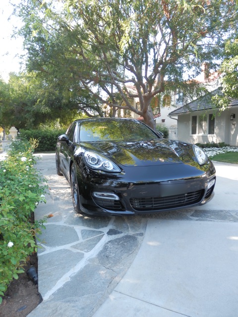

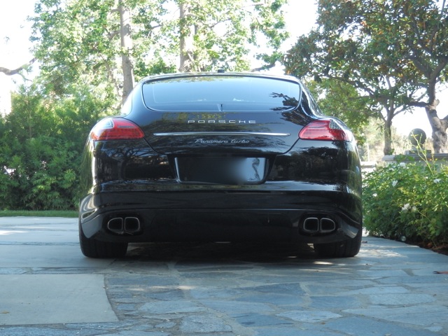

I just got 7 mm on the front and 15 mm on the back...looks great...I was worried...but turned out perfect.
Old Jul 20, 2011 | 06:53 PM
JCBH's Avatar
Posts: 447
From: Beverly Hills
Rep Power: 43
JCBH is a splendid one to beholdJCBH is a splendid one to beholdJCBH is a splendid one to beholdJCBH is a splendid one to beholdJCBH is a splendid one to beholdJCBH is a splendid one to beholdJCBH is a splendid one to behold
here is a photo...

one more, different angle
