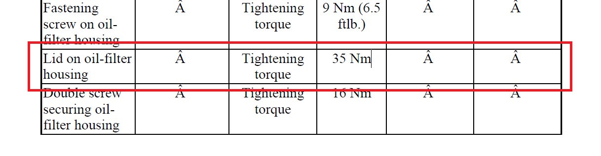

I actually went ahead purchase subscription on shop manual. For 2012 PTT. Drain plug torque is 22 ft lbl and for oil filter lid is 25 ft lbl. I think 37 ft lbl is too much since OEM drain plug is aluminium.
I just found it it is:
Oil drain Plug: 30 Nm or 22 ft/lb
Oil Filter Lid: 25 Nm or 19 ft/lb
So you are right - 37 ft/lb would be too much for the aluminum drain plug - also looks like you mentioned "25" which was the Nm measurement.
This all comes from the WM 1001IN (assumng that Porsche publication is correct)

I got this information from online manual. I checked again. It's 35Nm. I converted to ft lbl. Therefore it's 25 ft lbl. I am hoping I am getting correct information!
