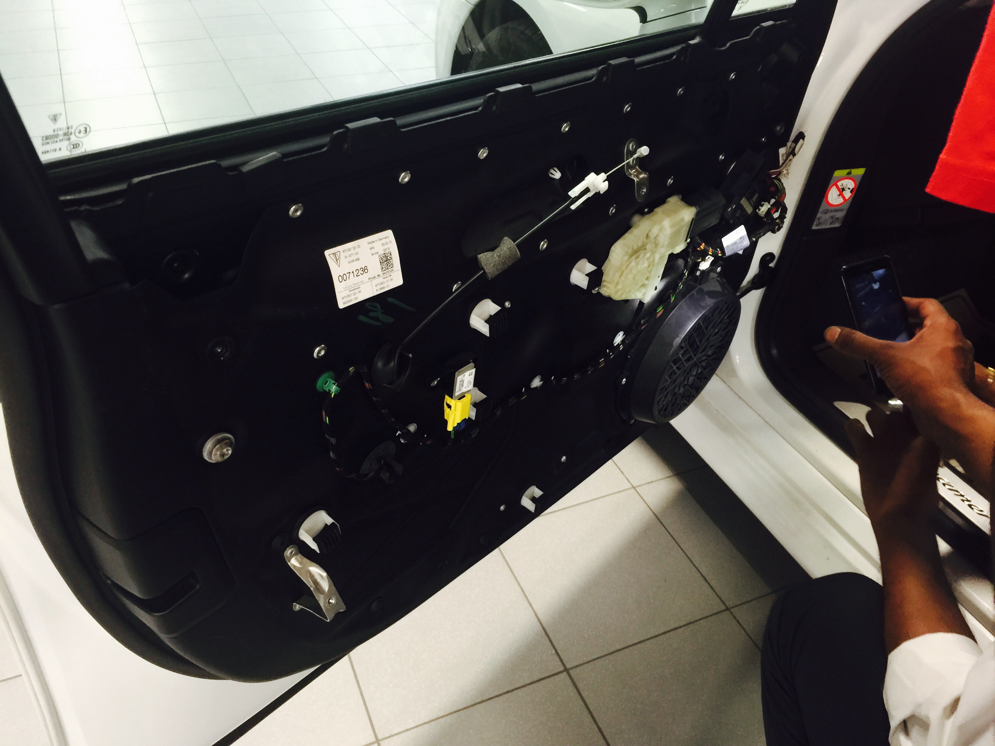

Door work today
Can see how interior of the door panel looks like u can notice speaking is held by rivets and not any screws or plastic

how easy is to remove the door panel? Do you have instruction or special tools need it? Thanks

Old Aug 19, 2016 | 10:16 AM
bebeqq1231's Avatar
Joined: Aug 2015
Posts: 158
From: Queens
bebeqq1231 is infamous around these parts
OMG! it's easier than what i expect. Thank you buddy
