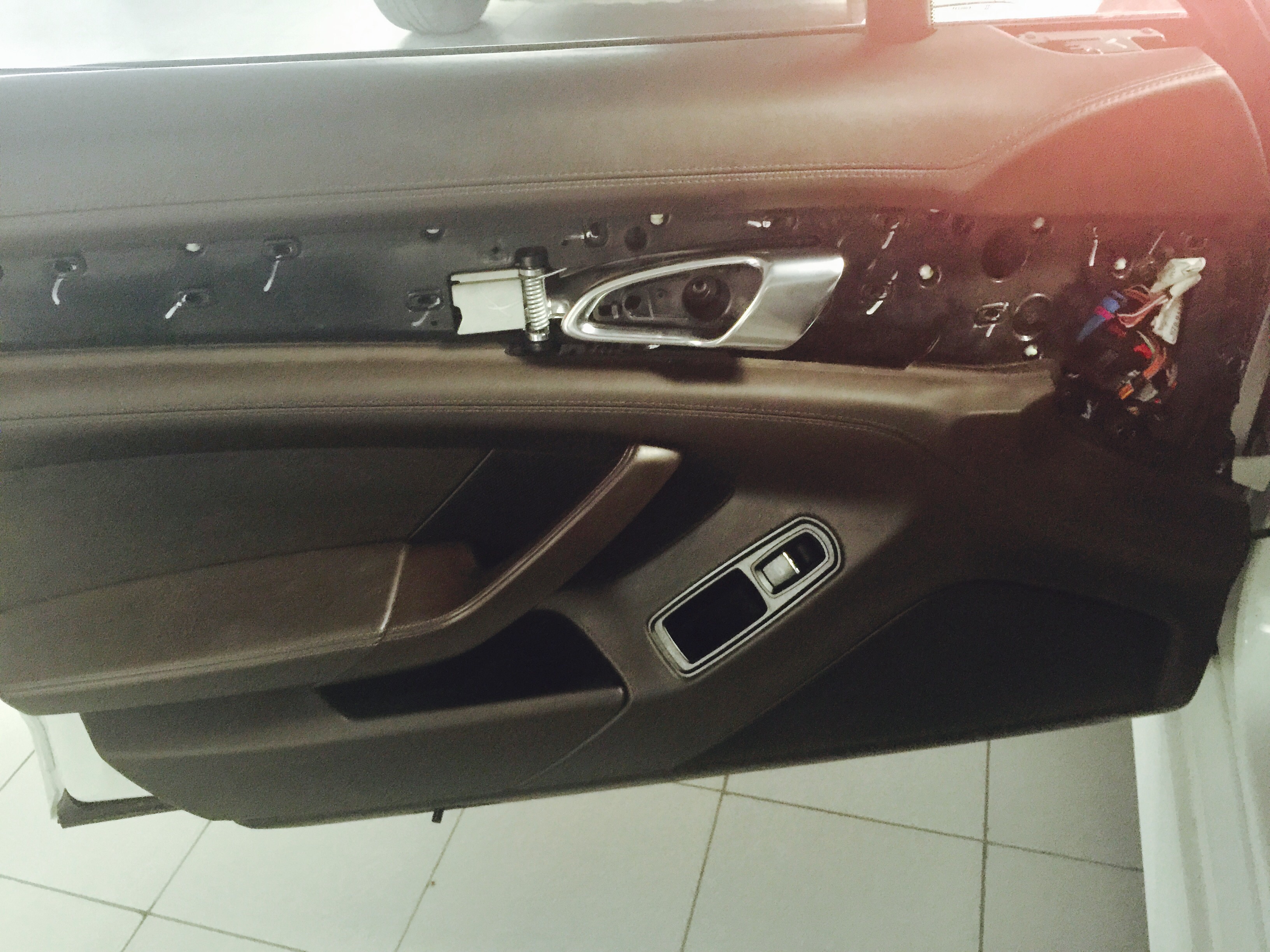

Rattles fixed
Hey
Am just taking the car back from the dealership just now. Door rattles were due to a loose speaker cover which is attached to the door panel itself. It's held with plastic clips which aren't as tight anymore rattling with base from speakers. Dealer fixed it by using Porsche supplied glue type stuff which is specially for plastic filling between the clip and the panel where it locks filling the gap where plastic clips had a play.
I had spoiler rattle n noise issue as well dealer fixed that by removing the spoiler and lubing it with Porsche supplied oil or grease.
Speaker housing as mentioned in first few posts is incorrect as speaker is held on to the door using steel rivets which don't shake and if they shake can't be easily fixed at dealer as they don't have tools to press metal rivets or plastic. Nothing can be tightened with the speaker housing but those rivets are damn good and chances of them lose are very very odd.
Hope this helps
