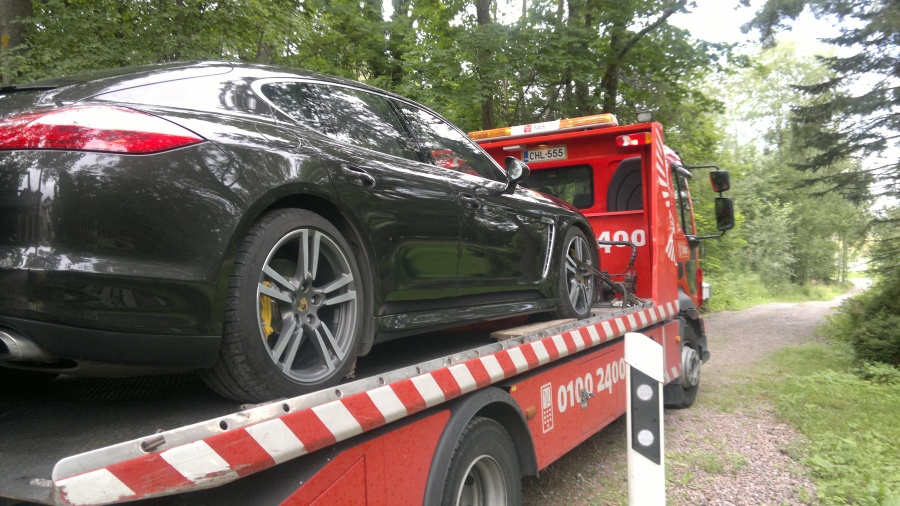

Oh yes, serious case of Dejavu!
Check engine light came on and engine was going uneven...
After a nice testdrive in the M5, I am getting tired of this!
