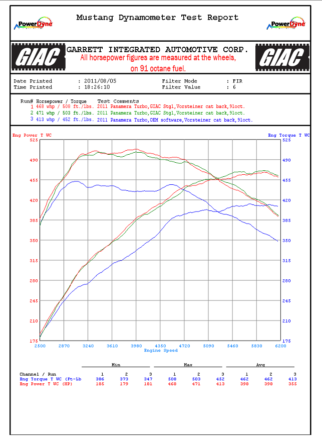

Originally Posted by NelsonF
These are known good upgrades and well validated. I have the same combo with GIAC tuned for 91 oct.
Here's an example of just an ecu upgrade alone on a PTT. Easy upgrade, and you'll love your beast even more afterwards. Good luck.
Keithta Porsche Panamera Turbo Flashed 600 HP. 1/4 Mile Drag Strip, 0-60 mph, 1-150 mph & Drive bys - YouTube
It is nice to have a true ECU recalibration that you can turn on or off at the push of a button, right?
With 91 octane, you should see similar gains to this, which are greater than anything else on the market. Panamera Turbos are definitely one of my favorite cars to drive with a software upgrade. They are brutally quick and very unassuming.
At the crank, you will see about 575 horsepower and 620 ft. / lbs of torque out of a Non-S model.

I did IPD Plennum and GIAC software. The Plennum was done first and improved performance "on boost" but added a bit of lag around town, takes just a brief second to pack in the extra air, but once in car works better on all fronts.
I then added GIAC software and it is the best mod you can make for the money. Nothing else will have the same performance impact as this. The car has improved tip in, less lag, more on boost power at all RPM levels. And "on boost" the car is just that much faster with added hp and torque across the power band.
I have modded a lot of Porsche's over the years and have found GIAC to be very reliable and great to work with. I would not do any tune that was not a full software upgrade. GIAC also provides the controller allowing you to convert back to stock in minutes should you wish to do so for a visit to the dealer.
