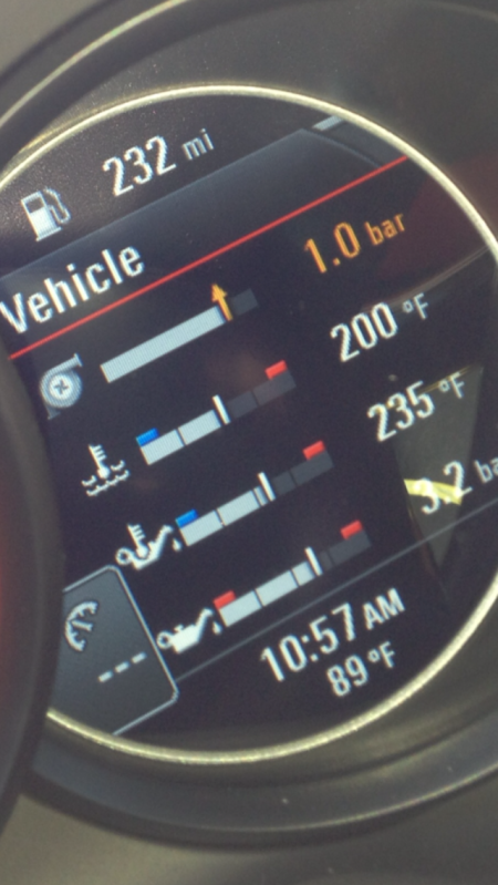

Hit 2000 miles so floored it and saw this..
Yeah man, that's Sports Chrono extending its legs.
You should see 1.1, 1.2 spikes, mine fluctuates A LOT from 1.0, 0.9, 0.7, it's never constant at a number.
Was yours steady at 1? If that's the case that is awesome! As it is not adjusting and lowering boost.

seemed to run a flat one bar, but like my other turbos and your experience is it will fluctuate some

You have a new 2013 Turbo S correct? If you get a chance would you mind taking a "leisurely drive" at some point and let me know if your boost drops below to 0.6bar or lower from 6000 to the 6600rpm redline in 3rd gear or higher? I am just trying to track down and verify if the actual cause of the boost drop off issue is just from bad BOV/diverter valves leaking or if the boost drop off is actually part of the stock ECU programming. Your car is new enough that there should not be a diverter valve issue yet, so if it too drops off I can then infer that it most likely it is also part of the ECU programming to drop boost off in the upper RPMs.
As an example of what I mean, if you check out this top speed run by Maroc on Youtube you will clearly see that boost pressure drops WAY down to 0.4bar (5.8psi) in the 6000-6600rpm range. This is a very clear indicator that his car does have the problem. Personally I am very impressed that the Panamera Turbo S is actually as fast as it is with this boost drop off problem. Maroc was still able to run 311km/hr or 194mph, and I bet it would easily clear 320km/hr or 200mph if his car was holding the minimum 0.85bar (12.3psi) of boost pressure properly on the top end of the rev range.
Stock minimum boost pressure on a normal Panamera Turbo is supposed to be 0.6bar or 8.7psi with a temporary jump to 0.84bar (12.1psi) during over boost. On a Turbo S stock minimum boost pressure is supposed to be 0.85bar (12.3psi) with over boost hitting a minimum of 0.93bar(13.5psi) or greater depending on fuel used (91/93 octane) and weather conditions.

Well that actually distorts the test results a bit, should have asked you that first, I thought you were bone stock just passing by your 2500 mile recommended vehicle break in period. The addition of the IPD plenum, the replacing the factory cats with 200 cell cats, and the resonator replacement with the X-pipe each will contribute to higher boost values and also help to hold more consistent boost across the rev range, especially on the top end. They are all great mods!
