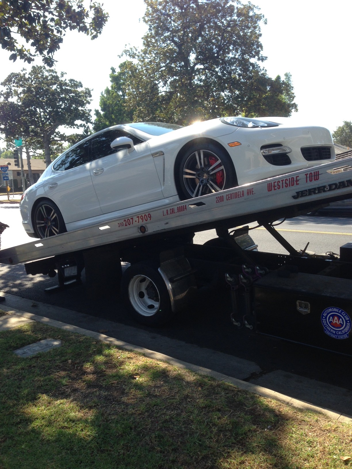

Driving into work this morning, coolant level is low warning comes on then engine temp warning. Pull off the 405 and then smoke from the hood
Got a flat bed to pick her up and brought it to the BH Porsche dealership. I'm thinking the coolant hose or radiator. A lot of fluids leaking underneath. Anyone else have this issue before? It's a 2011 PTT with 23K miles on it.
My loaner is a 2012 Panamera V6. Pretty peppy for a V6, actually very surprised.
Not sure when I'm getting the car back.
