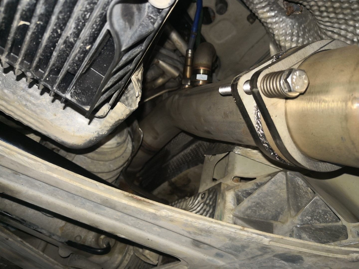

So, everything went Ok, just took around 12 hours, of course on the lift, second time would take twice less, I hope.. Studs didn't break, but they are standard size/thread so wouldn't a problem to order them at any car parts shop, and wasn't needed to disconnect active front sway bar, just to lower...
What I didn't like that was no included into kit - turbo/downpipes gaskets and clamps for downpipes/exhaust, I'm saying that because when I ordered downpipes kit I was told that everything will be....
