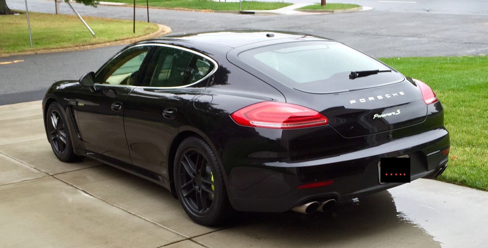

Attached is the customary/mandatory pic of the Panny!
