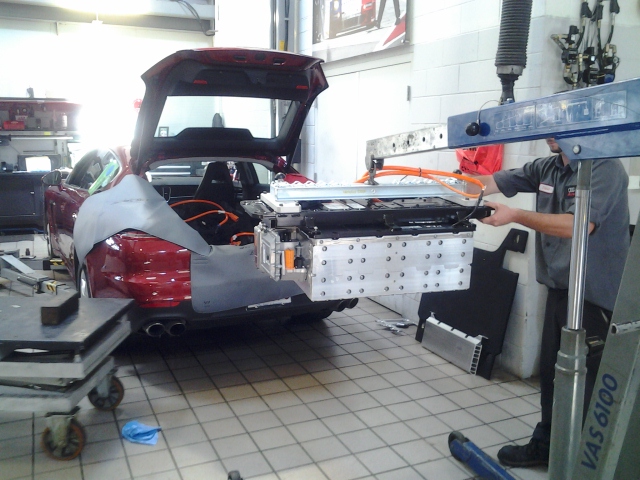

As long as we're updating this thread, I should mention the battery coolant issue I had the last month. When I brought the car in for annual service, they told me there was a service bulletin to replace the battery charge controller. Which took them 3 days, since it involved pulling the battery out of the car.
When I drove the car home, I got the coolant light again. I checked both systems, and sure enough, the battery tank was well below minimum. Because of the previous incident, I had coolant on hand, and filled it.
I called the dealership and told them about it. They claimed it was probably an air bubble. The next time I took the car out, the level dropped again, though I didn't get the warning. Off and on over the next couple of drives the coolant either stayed level or dropped.
After time #3, I was sure I had a problem, but I wanted to verify it before trying to brave dealer skepticism. Next drive it didn't happen, but I was in Sport mode a lot. I reasoned that maybe I need to heat up the battery, so I made an effort to do my next trip on battery power alone. The coolant didn't budge after 12 miles of electric driving.
So, maybe it was an air bubble after all, but a big one. Keep in mind that the difference between "maximum" and "minimum" in the battery fill tank is pretty small - I'd guess it's maybe 8 ounces of coolant.
I honestly don't know, but I'm feeling concerned enough about it that I'm keeping the bottle of coolant in the car until further notice.

The one issue I did have repeatedly was coolant level. The e-Hybrid has two cooling systems, one for the combustion engine, one for the traction battery. The traction battery system threw a "low coolant" warning about 3 months into ownership. After they pulled the battery in September 2015, I had to top up the battery coolant system several times (as I related in this thread).
