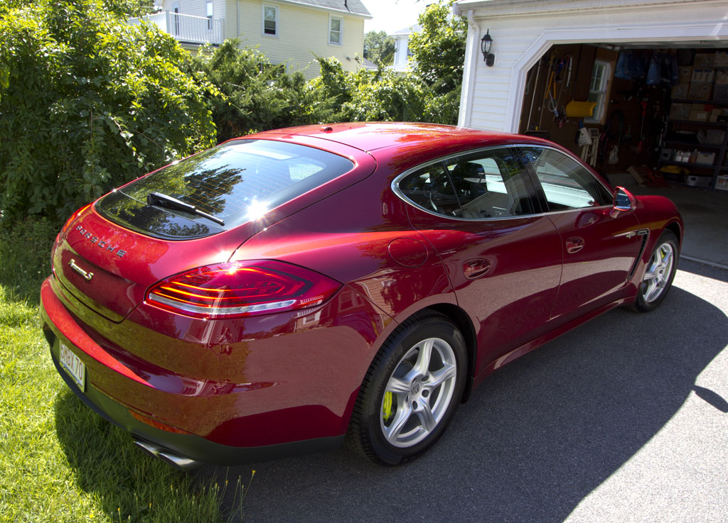

I decided I wanted a Panamera S e Hybrid in April, but wanted an interesting color like Ruby Red or Sapphire Blue. Neither was available in stock, so I ended up ordering. I took delivery yesterday, drove it a bit today.
Attachment 1
The dealer delivered it to me with the battery completely empty. This didn't really surprise me - I don't think they understand the car at all. When I test drove one, they didn't have that one charged either. I charged it before taking it anywhere.

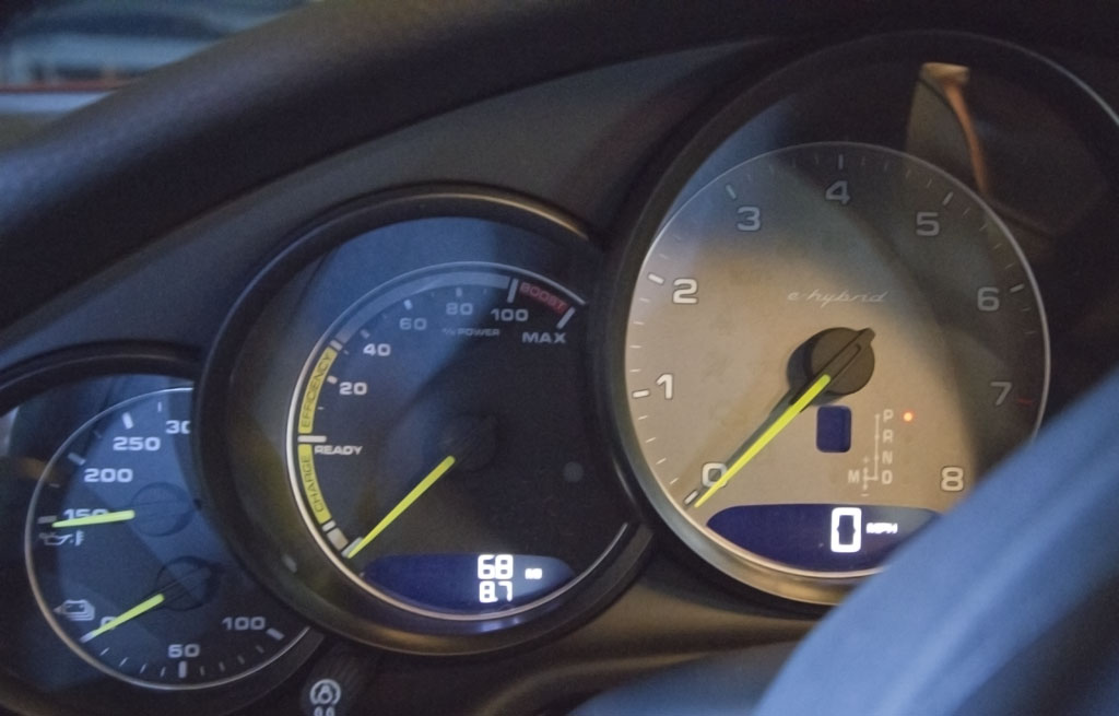

One thing I thought was a bit weird and silly is that the car doesn't have an analog speedometer. There's a digital one below the central tachometer, but in the #2 place, where you'd normally see a speedometer, is a power meter. It seemed frivolous to lose a significant instrument for this.

After driving the car today, I realized this is the electric power's equivalent of the tach, and thus it is important, if you're trying at all to maximize efficiency. In e-Power mode the car is pure electric until the power meter gets over 25%, the green zone, and then the gas engine turns on. It's very easy to do this in ordinary driving. The EPA includes some gas usage in the PSeH's electric-mode MPGe, and I now understand why - if you're not keeping an eye on the power meter, you're going to use gas.
Similarly, if you're braking, the meter tells you how hard you can press the brakes and recapture energy. Go beyond the bottom of the "charge" zone, and you're using the real brake pads, not the electric engine braking to generate power.
I had envisioned staying in completely electric mode for routine driving, only reserving the full engine power for times when I really wanted acceleration. I don't think that's going to happen. The electric is very nice for 0-5 MPH, giving real authority from a standing stop in a way that usually requires a lot of gas. It's not so nice above about 15-20 MPH. I experimented with pegging the power meter at 25%, getting maximum acceleration from pure electric, and getting up to 35-40 MPH is definitely slower than I find acceptable. This is a heavy car (4600 lbs), and the 95 HP of the electric motor isn't enough for my taste.

My main complaint about the car is that is suffers from serious tunnel vision to the rear. The rear hatch looks like an expanse of glass, but it's pretty far away from the driver, and visibility through the rear passenger windows is poor. I'm quite grateful it has a reverse camera. I also sprung for a Lane Change Assist, but I haven't noticed it doing anything yet.
