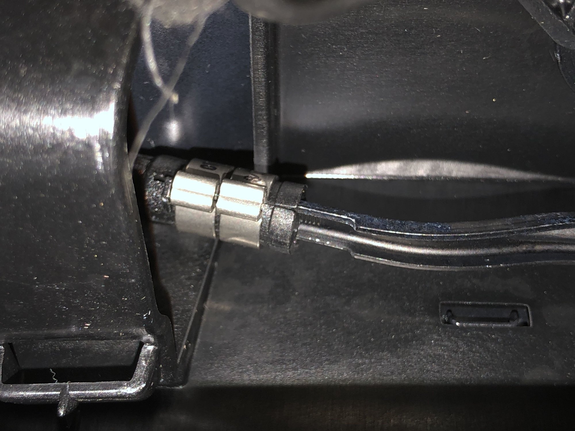

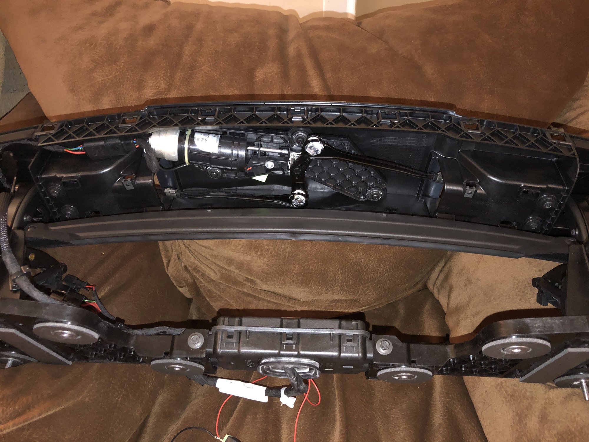

Thank you for asking, and this is a very good question. I don't know if you clean it with the two top spoiler pieces removed. If not, you did not do a complete job. If you have in fact cleaned it very well, then the cause was that item number 2 below is designed with a semisoft plastic shaft, which can slip if anything is stuck, so that nothing will be permanently damaged. Yes, there are 4 independent adjustments in this design:
1. the base of the rotating arms
2. arm-length of the center sweeper
3. step motor for the horizontal 2D motion
4. rotation limits of the far(outside) arms
To be fair to those who has attended my paid one-on-one class, I am not able to provide all the details. I did provide my students with a few tools that I invented, which makes the job a lot easier, and less likely to damage your car. However, the job can still be done without them.
Here is part of the cheat sheet I provide in my spoiler maintenance class:
To remove top two spoiler pieces, remove metal clips using NAPA pick hook tool, then use tool 9XX970.218 and 9XX991.115 provided, remove the rod from the center joints...
So, to make it balance, it must be done off the car. Get a 12V DC ready. Plug B is only for sensors so we don't need to use that. On plug A, pins 1-8 is for vertical, and pins 4-5 are for horizontal. apply power to 8 and 1 to fully extend, then apply power to 4 and 5 until apex. Remove the lower plastic plate and then the four screws, and remove cover.
Adjust the left and right bases by tightening the bottom screws to 2N-m and back out half turn (the three shown with red arrows. Now, adjust the motor assembly location, and check for symmetry. Repeat as necessary. ...
Using tool 9XX970.218 and 9XX970.219 and a hammer to ensure rod is fully inserted, and reinstall retainer clip.
I do not perform repairs because I believe that is an act of stealing business from the Porsche Service Centers. However, I do provide training classes to enthusiasts. Because even without my class, they would have taken it into their hand and tried to figure it out themselves anyways; but may be breaking a few things along the way. Taking my class saves them the hassle of having to figure out the skills, tools, and forces to apply so that they can focus on the finding the best approach, and spend more time fine tuning everything, and save them from the hassle of waiting on shipping of replacement parts that could have been otherwise not broken, so that they can get done and continue to enjoy the car that they have fixed all by themselves. I do need to mention that I do regularly teach to use 9XX exclusive tools in addition to what Porsche's Service Manual prescribes, to make the job either easier. Porsche is meant to be enjoyed. Let me know if I can do anything to help. Here are a few pictures I took during a turbo spoiler class. Spoiler belonged to a 2011 Panamera.
