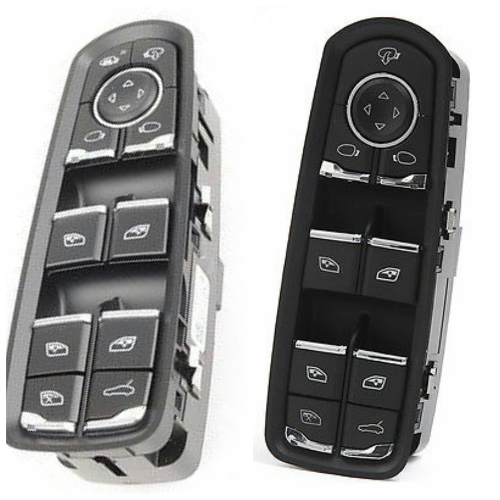

Anyone need a non side assist control in great condition? I am putting in the correct one on mine.
Right side of the pic is what I'll be posting for sale. All the chrome tips are intact.

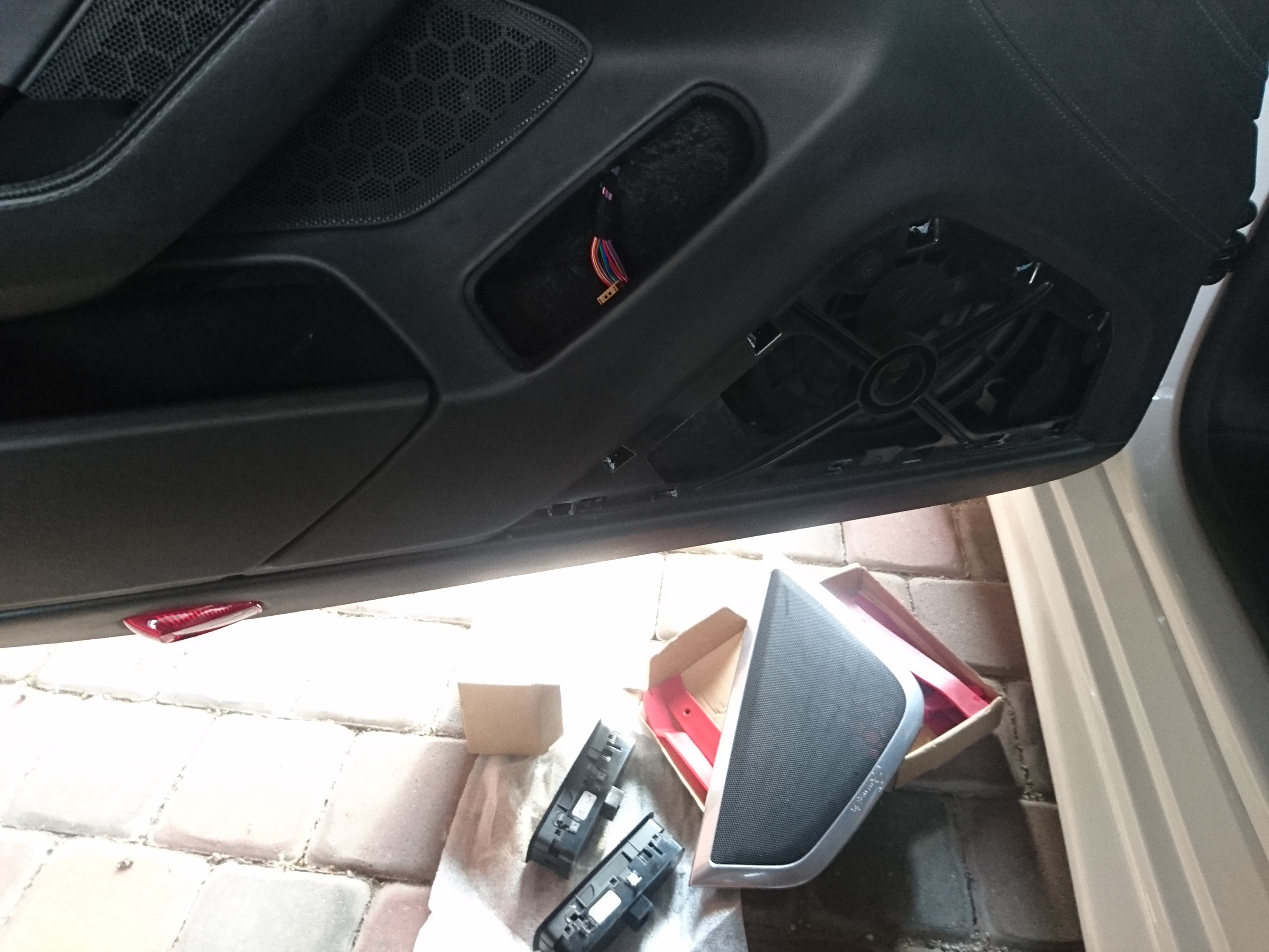

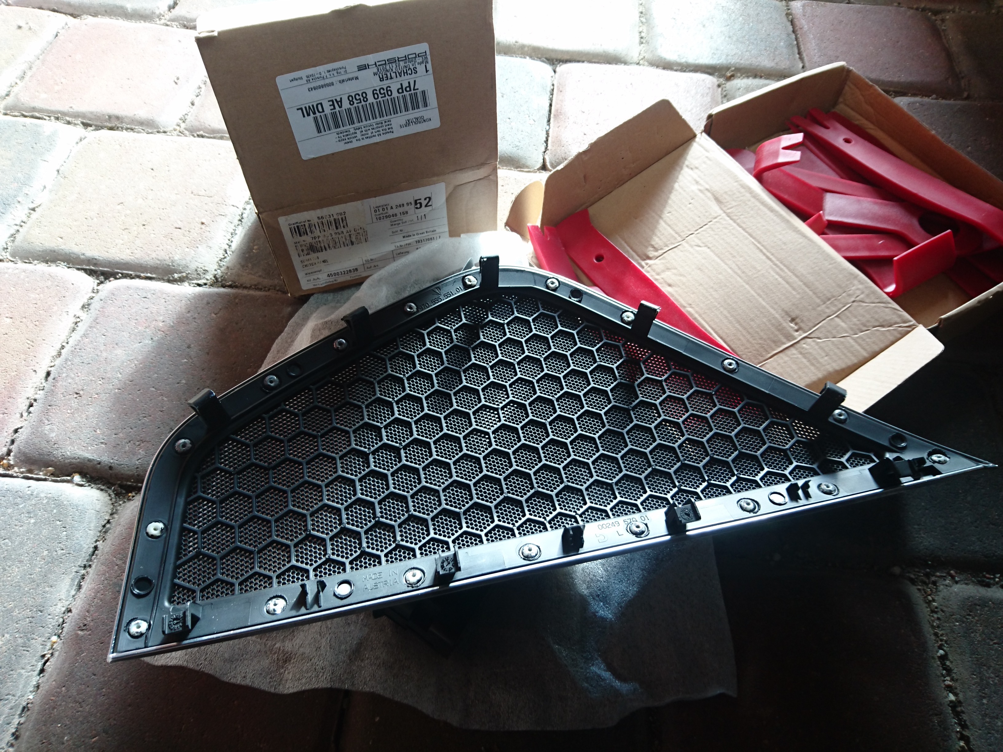

Yes, the best way (and safest for the leather) to replace this switch is through speaker grill. Just in my case speaker (maybe there are some differences between Burmester and Bose) didn't come off, was no need for that, enough space to reach switch with hand through inside and push it out. This job took me not more then 10min doing slowly and carefully.

I didn't go this way because it looked to me too risky of damaging leather around switch.
