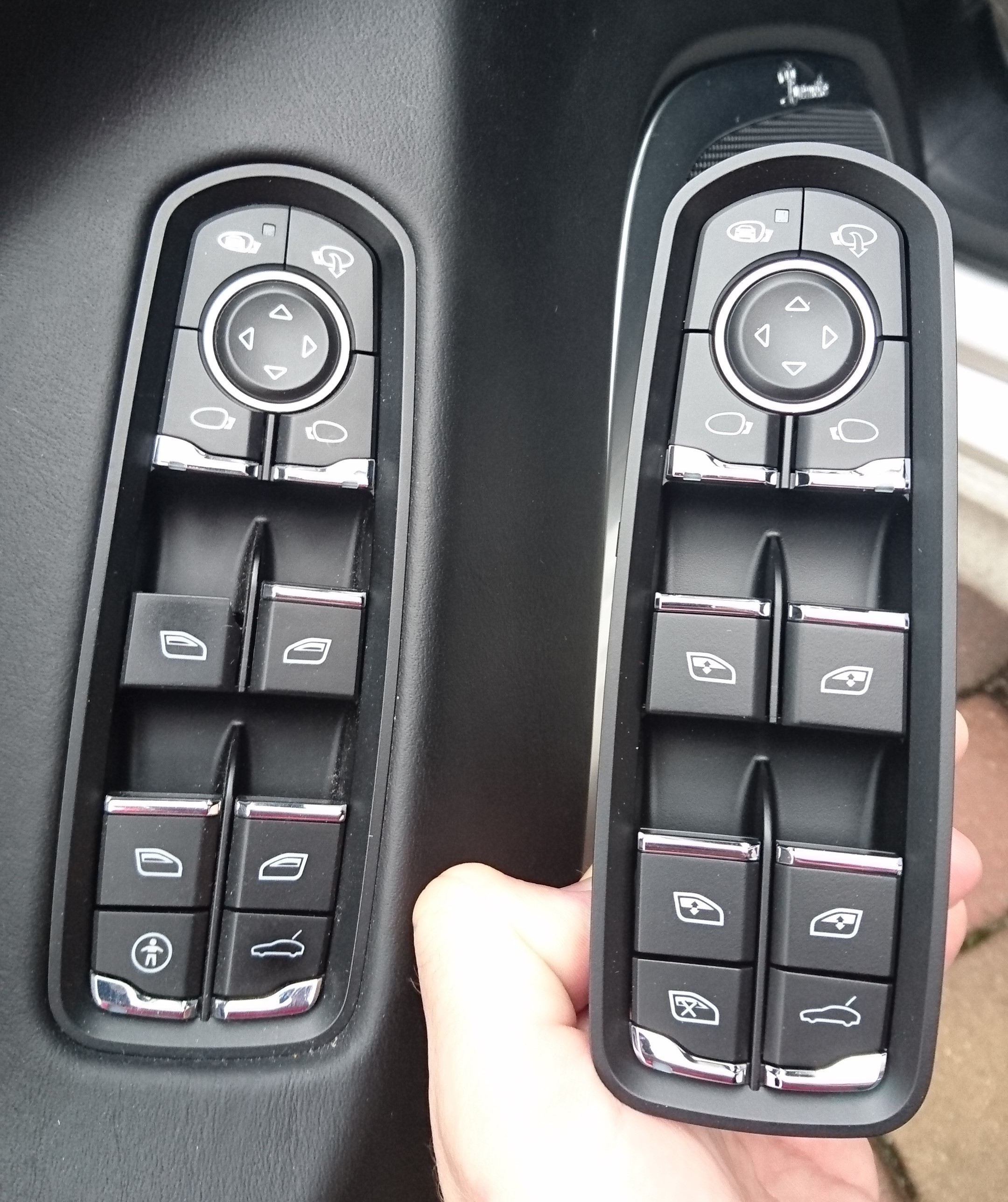

Originally Posted by sayadil
... I noticed new switch is better quality... Also if u notice the child lock sign has changed. I preferred the child logo over the window logo on the new one.
Received mine, 104 euros .....
Name:	7PP959858AEDML - door window switch front left black NEW.JPG

Originally Posted by negb
hmmmm, very strange that such breakdown was covered by warranty.... will see what my dealer will say about that, here are pictures attached of broken switch in my Panny
Mine is broken exactly like yours, I got my car like that. Doesn't really bother me. I never would have noticed if the Dealer didn't tell me.

May be taboo, but have you guys noticed the chinese have replicated this part, possibly due to the crappy oem quality (always breaking). My first panamera came with a broken switch. I picked up a chinese aftermarket one on ebay for like $40. I attempted to remove the door panel per a youtube video, but after following all the instructions, I couldn't get the door panel to pop off. I ended up removing the speaker grill by the switch, removing the speaker, reaching in and pushing the switch up. Side by side oem and chinese look identical and the replacement works perfect. Just picked up a V6 panamera with the same issue (pass side window as well). Bought the same replacement, this time on amazon. $40 for driver, $10 for pass.

Originally Posted by ddx77
My car has the Bose, not sure of the original post. Thanks
like i said i tried to remove the whole door panel per a video on YouTube (type in panamera door panel removal). I got to the very end but the door panel wouldnt pop out. Frustrated i played with a few options and realized i could pry off the speaker grill. Mine is bose as well. Only way i can explain it is to get a very thin screwdriver or trim removal tool and start at the very front of the grill. Once you can see how its held in you can pull it off slowly.

FYI - On a Panamera (Turbo w/ Bose speakers). You can remove the speaker grill, pry the front corner with a small pick or hook and just work it back and forth and slowly pry back. Be careful, a lot of fine leather, so take your time and have patience. The entire speaker comes off. Unplug the harness with your hand inserted into the speaker opening. Then start to push up on the window switch. It has 4 metal clips, not sure an exact strategy here, I just sort of worked it back and forth on each side and it came loose that way.
