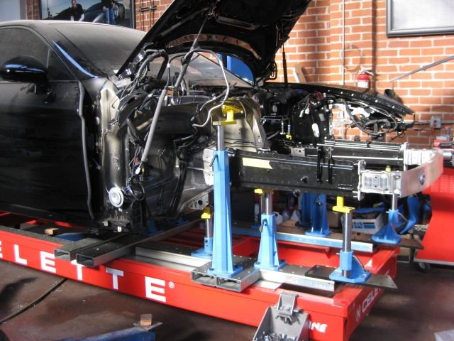

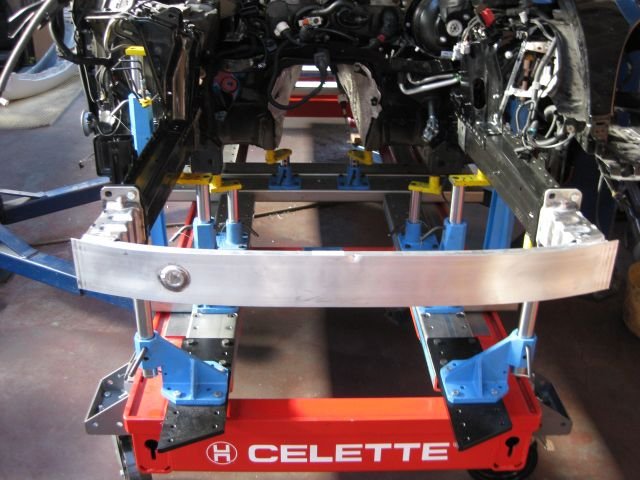

There is insufficient frame rigidity left without the bumper assembly connecting the frame rails. See pics below or check out a Pan body in white to see the frame exposed.
Pan having aluminum frame rails replaced after the rail cracked during a front end collision.

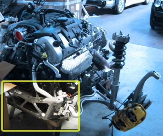

Engine, tran and suspension components dropped. Pan has NO other major frame components forming its structural box. The frame rails and the bumper assembly are the only major components to provide the frame rigidity needed for steering control and suspension function. There is only a small sub frame provides any cross supports between the rails. With defective welds between the frame rail ends and the bumper assembly, the Pan has a wet noodle for a structural box.
Engine dropped from Pan under repair showing small sub frame attached to engine.

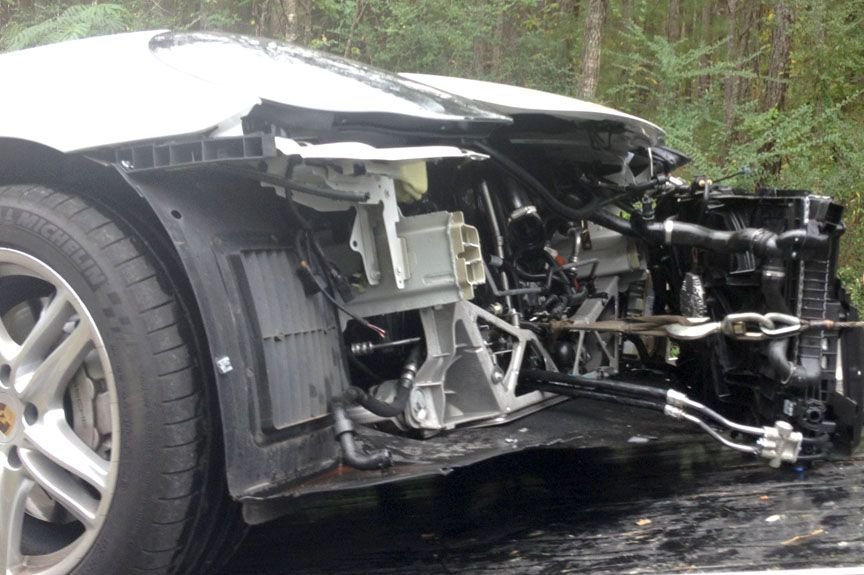

My car is shown above being reloaded onto the wrecker after the catastrophic failure of the welds on the frame rail ends. I drove this car while those welds were beginning to fail. I can a thousand percent tell you without a rigid frame being provided from those welds the car darts, wanders, drifts, pulls, jerks, changes direction abruptly just due to going over small road imperfections, etc. etc. etc...
There is very strong reason manufactures of production vehicles and race vehicles make a frame as rigid as possible. It gives better control. Even an after market sway bar can help a car handle better, corner better, etc..
Given any version of Pan weighs over 2 tons, that is a hell of a lot of mass to leave to the small sub frame that is the only remaining cross structure left. That sub frame is seen in the exposed end of my car above and in the dropped Pan engine at its base.
