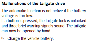

How do we open rear hatch if battery is dead?
How do we open rear hatch if battery is dead? I couldn't find the relevant section in the manual. Can someone help point this out? Thanks!

Try this (below). Otherwise it the battery is completely dead, apply power via the battery terminal posts under the front hood, first.

From the manual...sorry the picture didn't copy / paste
Emergency operation of tailgate
If the tailgate still cannot be opened (e.g. if the vehicle battery is discharged), the emergency operation must be performed:
Fold the rear seat backrests forward.
Please see the chapter “FOLDING REAR SEATS FORWARD AND RETURNING TO UPRIGHT POSITION”.
Enter into the luggage compartment via the folded-down rear seats.
Unclip the light A on the inside of the tailgate (on left in direction of travel).
The release cable for opening the tailgate is located in the trim above the light.
Unclip the emergency release cable from the bracket B and pull in direction of arrow.
You will hear an unlocking noise. The tailgate can then be opened by hand.
Clip the emergency release cable in the bracket and then clip in the light.
