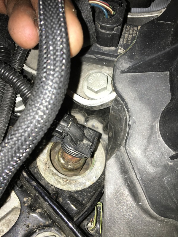

Question 1: How does one remove the clip on top of the strut without breaking it?

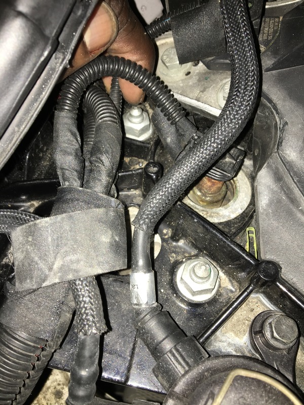

Question 2:
I'm assuming that there is a 3rd nut holding the strut mount, but before I start tearing it down, can anyone confirm?
You can see the visible two here:

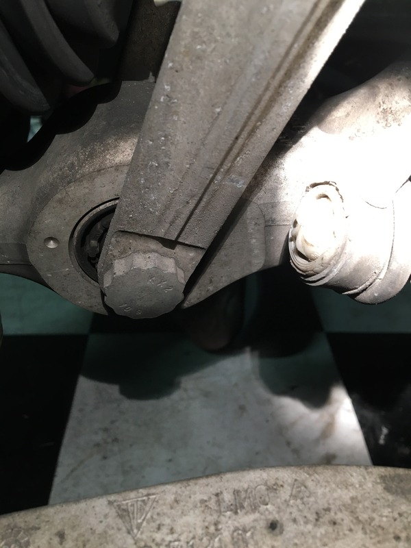

Is there a special tool for this bolt end? (lower strut mount)

pull the clip for the PASM straight up.
there is another nut, keep removing those panels.
no special tool needed. If I remember correctly thats just a normal 12pt socket (dont remember what size though)

when doing the front struts, make sure the middle portion of the strut (for the pasm) does not spin. You will need to hold in place..I think I used an 02 sensor socket, but it took forever.
