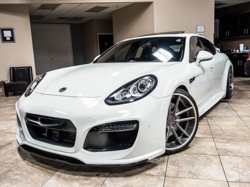

benblack. That car looks absolutely sick. Do you have a thread with more pictures of it? I just ordered the Forgestar F14 in 22" Wanted to use super deep concave, but aparantly there would be clearence issues with my ceramic brakes. So only deep concave. With 265/30 and 315/25. Was hoping for the same tire set up as you have, but they told me it was not possible.

We did it so depends on their offset figures. Maybe they are just being conservative tires this size are expensive. So going your route will be alittle easier on the wallet and I believe there is more tire options. Here's the car with the tires on before we did the widebody and I had new ones made

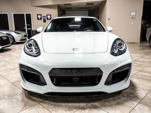

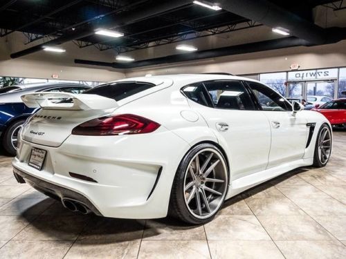

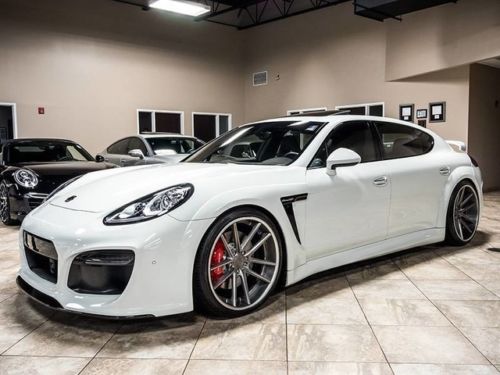

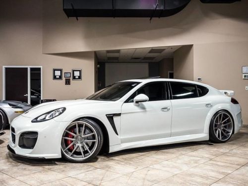

Okay, I've compiled everything I could find on fitment as my primary motive is to not use a 25 series in the rear. I've already read another post that said nothing larger than a 29.0" diameter will not fit and it will rub. There were no other details. I know for sure that 29.9" diameter will rub in the front.
My hope is to try the two fitments that are in bold below. Any thoughts on if the 265/35/22 with 29.3" diameter will fit?
Stock Turbo II Wheels:
Front: 255/40/20 on 20"x9.5" with 65mm offset = 28.0" diameter
Rear: 295/35/20 on 20"x11" with 68mm offset = 28.1" diameter
Fitment that does NOT work:
Front: 285/35/22 = 29.9" diameter = rubbing in front
Rear: unknown, but irrelevant since fronts don't work
Fitments that MIGHT work (but matching tires can be hard to find):
Front: 255/35/22 = 29.0" diameter (no matching tire that I can find)
Rear: 295/30/22 = 29.0" diameter (no matching tire that I can find)
Front: 255/35/22 = 29.0" diameter (PIRELLI P ZERO NERO GT 280 AA A)
Rear: 305/30/22 = 29.2" diameter (PIRELLI P ZERO NERO GT 280 AA A)
Front: 265/35/22 = 29.3" diameter (PIRELLI SCORPION ZERO ASIMMETRICO 420 A A)
Rear: 295/30/22 = 29.0" diameter (PIRELLI SCORPION ZERO ASIMMETRICO 420 A A)
Fitments that do work:
Front: 275/30/22 = 28.5" diameter
Rear: 325/25/22 = 28.4" diameter
Rear: 335/25/22 = 28.6" diameter (PIRELLI P ZERO)
Front: 285/30/22 = 28.7" diameter
Front: 265/30/22 = 28.3" diameter (PIRELLI P ZERO NERO GT)
Rear: 315/25/22 = 28.2" diameter (PIRELLI P ZERO NERO GT)
