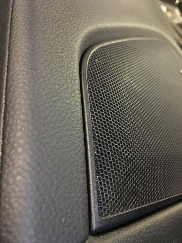

Separating the speaker grill from the door panel wasn't all that difficult, simply flip the door panel over and on the inside you will see 4 clips like this:
Simply pinch the clips while pushing or prying the grill out. The clips can be a little tough so if you resort to using pliers be gentle so you don't snap any clips. I just took my time.

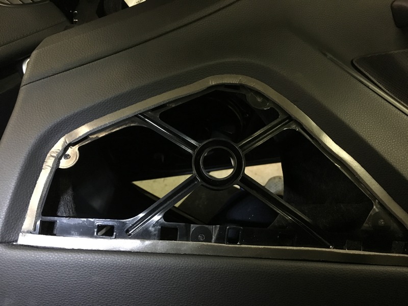

Initially I thought I could put the weather seal on the door panel itself like so:

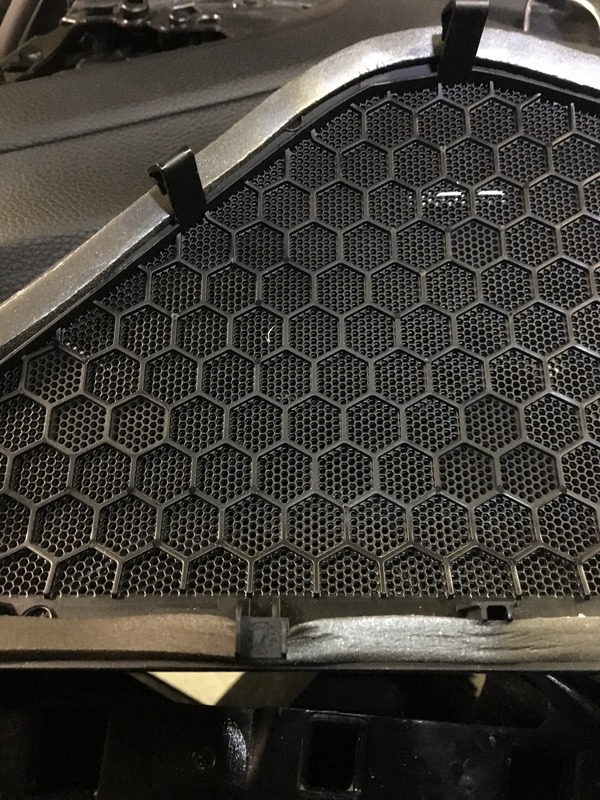

It wasn't going to work well so I opted to put the apply the weather seal to the actual grill itself, which worked fantastically!
The grills went back in perfectly and the slack between the grill/door panel no longer remains.
