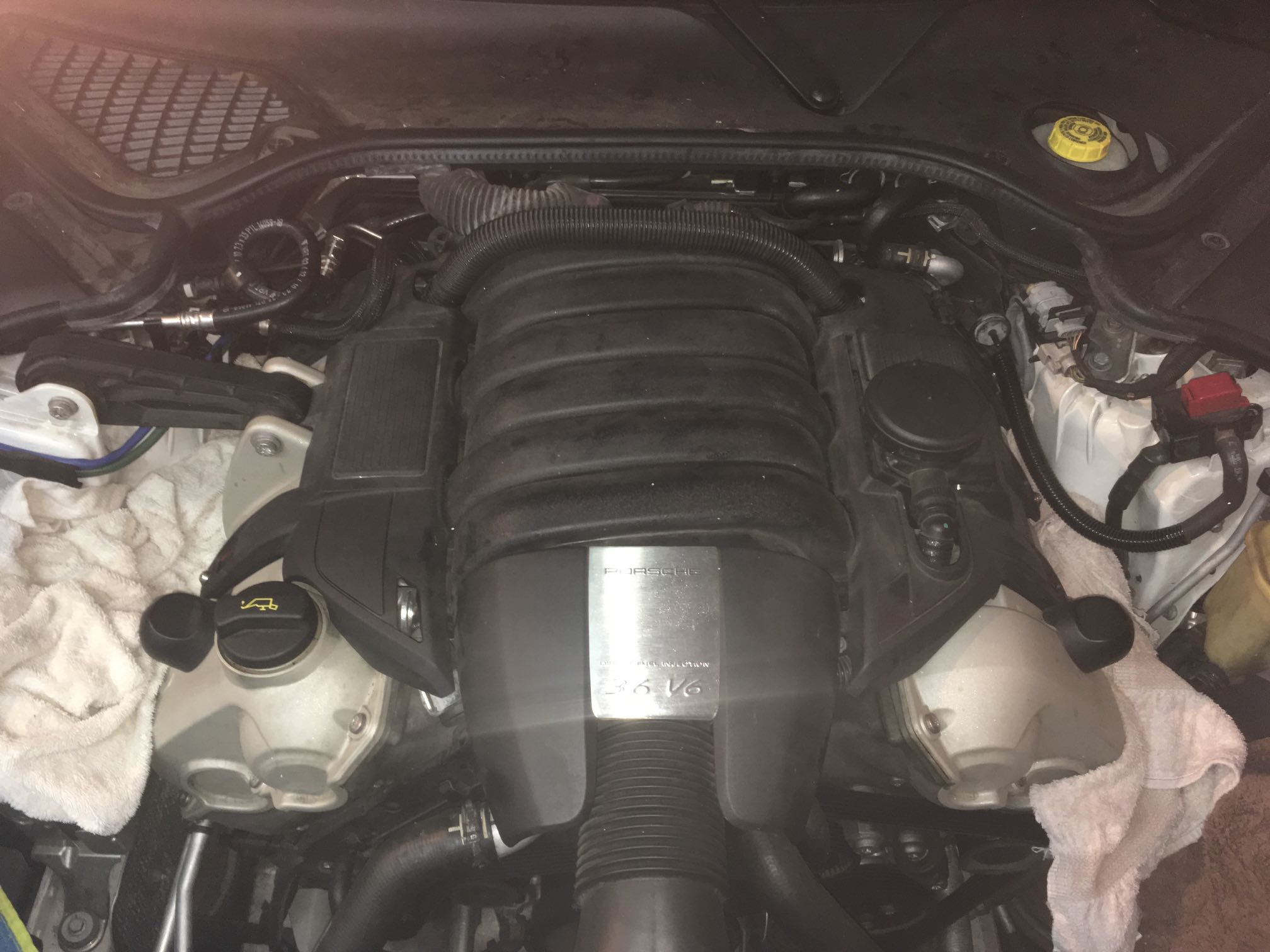

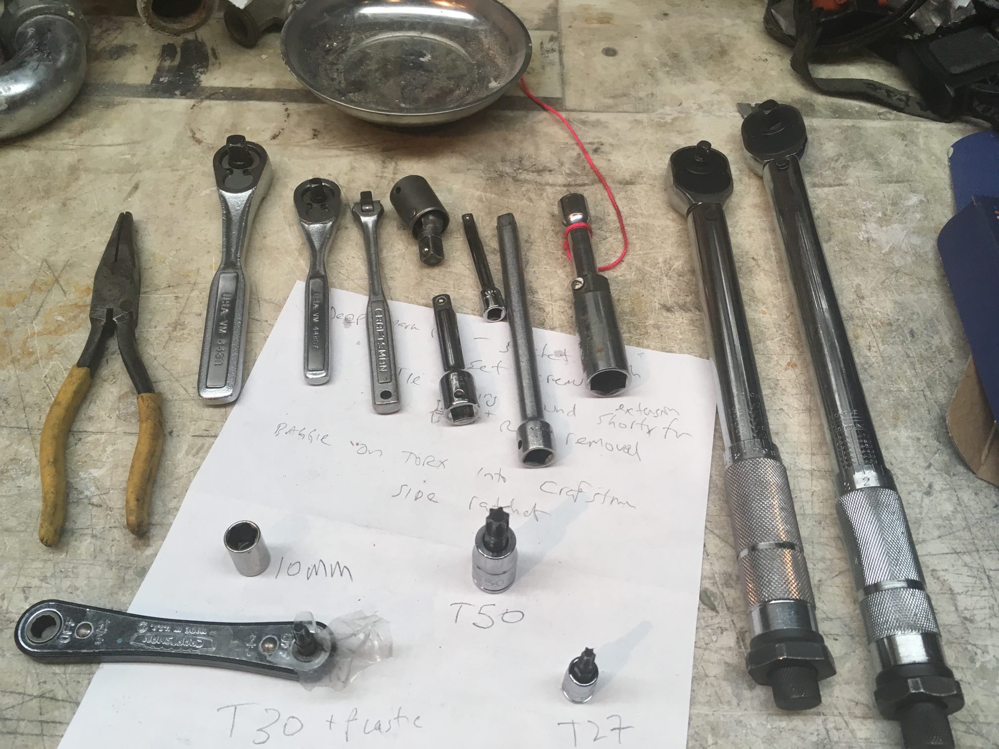

I took a couple DIY pictures and notes if I do plugs again.
1. Squeeze towels in under plugs to catch dropped screws and tools.
2. Spark plug socket with short extender and set screws/dimples. Tie a string to pull it off the rear 2 plugs. 22ft-lbs on plugs. 45ft-lbs on motor mount.
3. Side ratchet with T30 torx for cover.
4. 10mm can do jack screws, and be VERY careful on jack screw torque at 5ft-lbs
5. To move on passenger side: blue and green wires, detach 2 vacuum hoses, raise motor brace. Driver side: unclip connectors out of bracket, remove the screw from the 12v cable holder.
