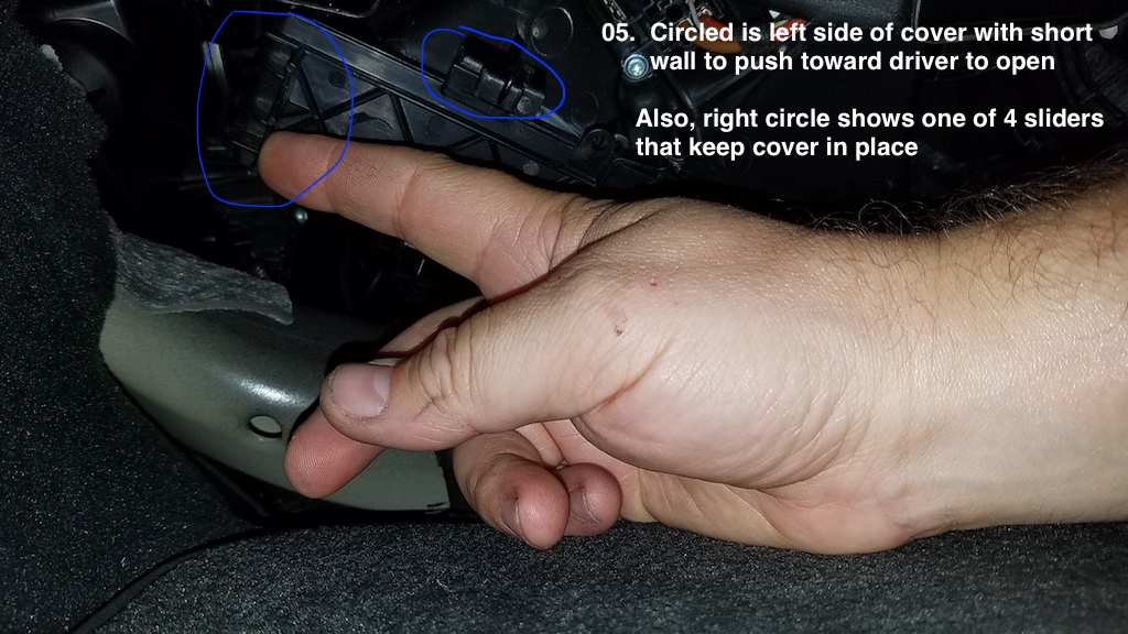

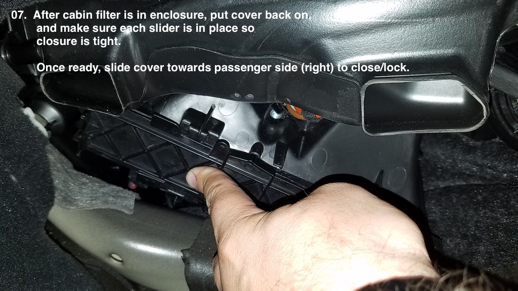

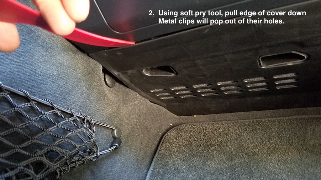

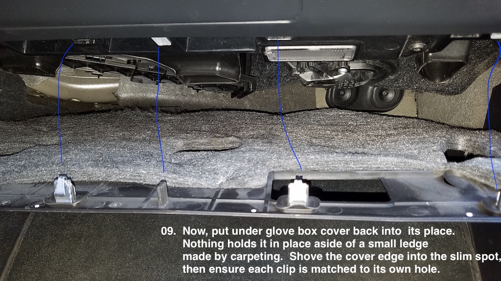

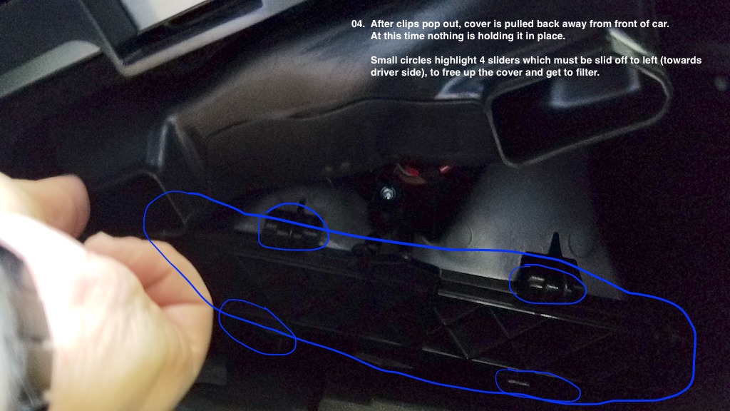

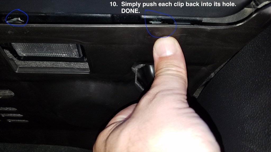

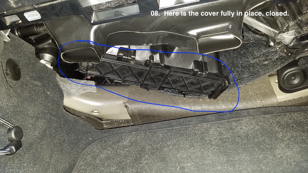

The hope is we will no longer have anyone say 'gotta take my Panamera to the dealer, to replace the cabin filter'.
If you still gotta go, might as well send me a couple hundred bucks for no reason at all (be glad to give you my paypal id).
Otherwise, it takes just a few minutes and you will have good air again.
Follow pics in order and you will be done in no time.
REMEMBER: ARROW POINTS TOWARDS FRONT OF CAR ON CABIN FILTER.
