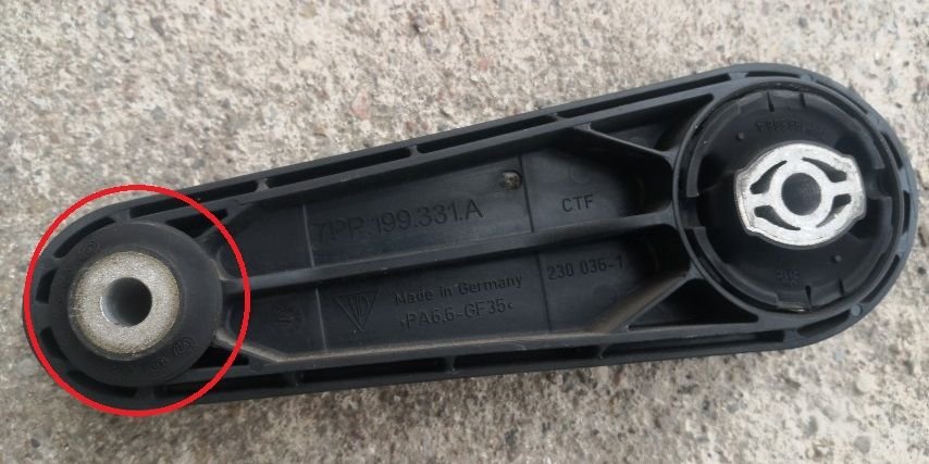

Originally Posted by stealthn
What was the torque for the engine damper?
What about this smaller bushing in this engine damper ? Does it have to turn in dampers housing ?
Or if it's turning means that needs to be replaced ?

Follow torque guidelines for both bolt. My diys have these listed somewhere for shock ir valve cover work, etc. Once you see rubber crack, replacement needed. Should not be spinning as torque and bolt fit will prevent that.
about 100 bucks for new replacement.

....... Once you see rubber crack, replacement needed. Should not be spinning as torque and bolt fit will prevent that....
no doubts regarding cracks, but I don't see any cracks, and of course bigger rubber is made to be solid, I mean in one piece with plastic part, but the one I
marked in red, I think it has to turn inside plastic housing, like upper control arms bushings, for example ... Otherwise I don't understand the purpose of
this damper...It should absorb 'movement' of the engine

It does not turn. The UCA bushings also do not turn.
