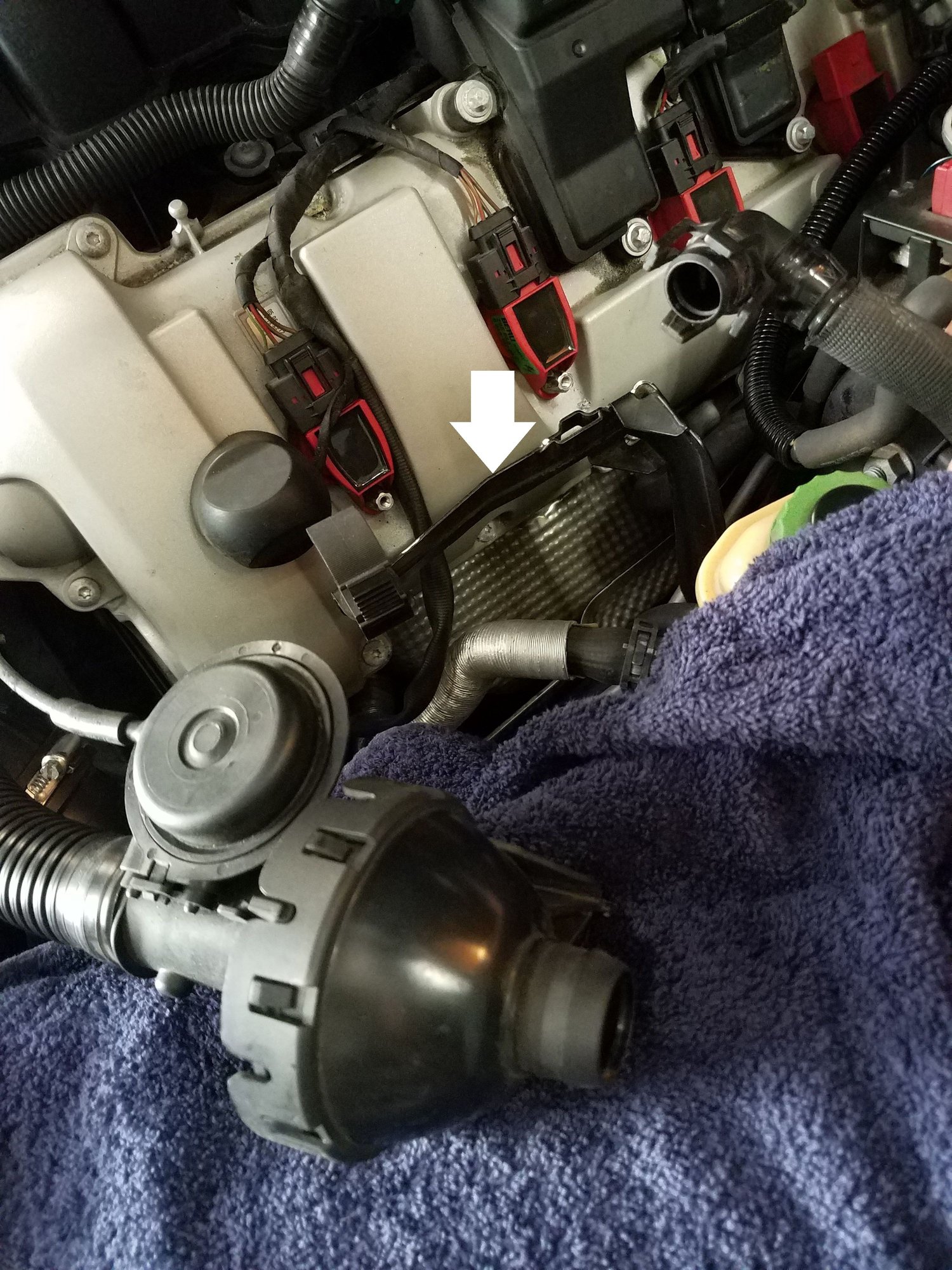

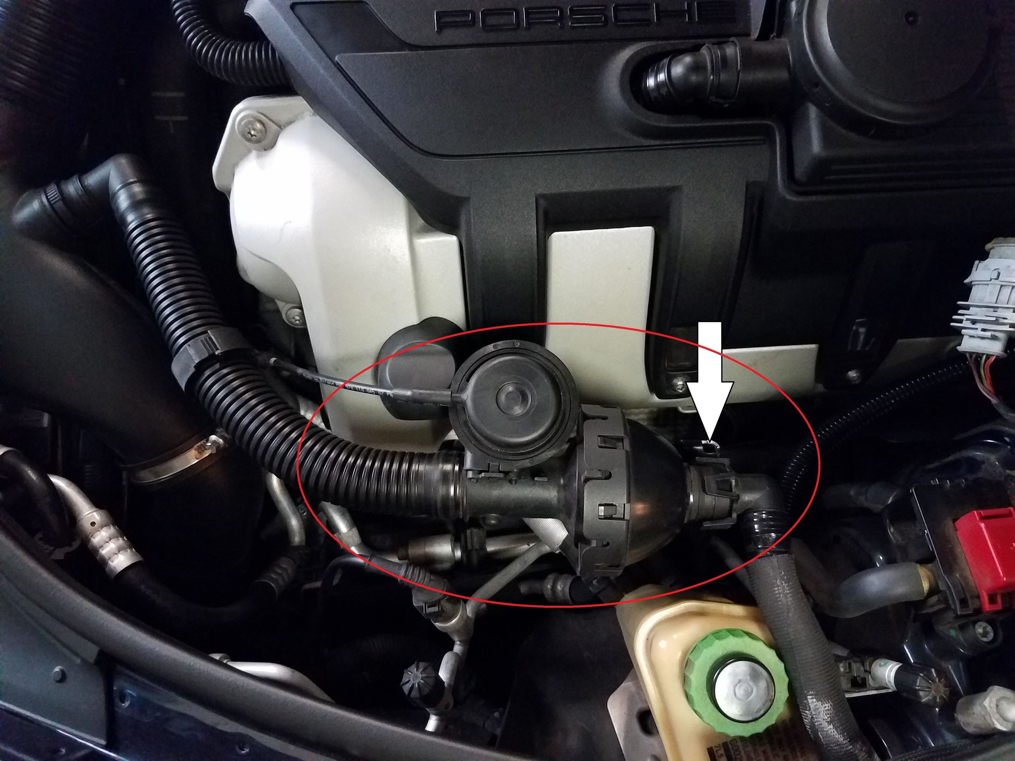

non-turbo addendum
Many thanks to ciaka for posting this diy. Used it as a guide when I replaced my plugs and coils this weekend
I have a non-turbo V8, and found that I had an extra part (circled in red in 1st pic) that needed to be positioned out of the way so that I could access #5 cylinder (driver's side, furthest away from the firewall). Just had to simply undo 4 clips (white arrow, 1st pic) on the part to separate it from a hose, and then unclip it from the mount holding (white arrow, 2nd pic) the part....then move assembly out of the way.
Accessing, removing and replacing the coils and plugs on cylinders 1, 2, 3, 5, 6 and 7 were easy. The two cylinders closest to the firewall were a real pain. Limited access, little working space. Needed every wobble extension and swivel joint to get to the plugs.....plus that little 1/4 ratchet. Patience is needed.
Never could remove the plastic connector/tube holder shown in ciaka's slide 5 and 6. Ended up breaking it in frustration.....
