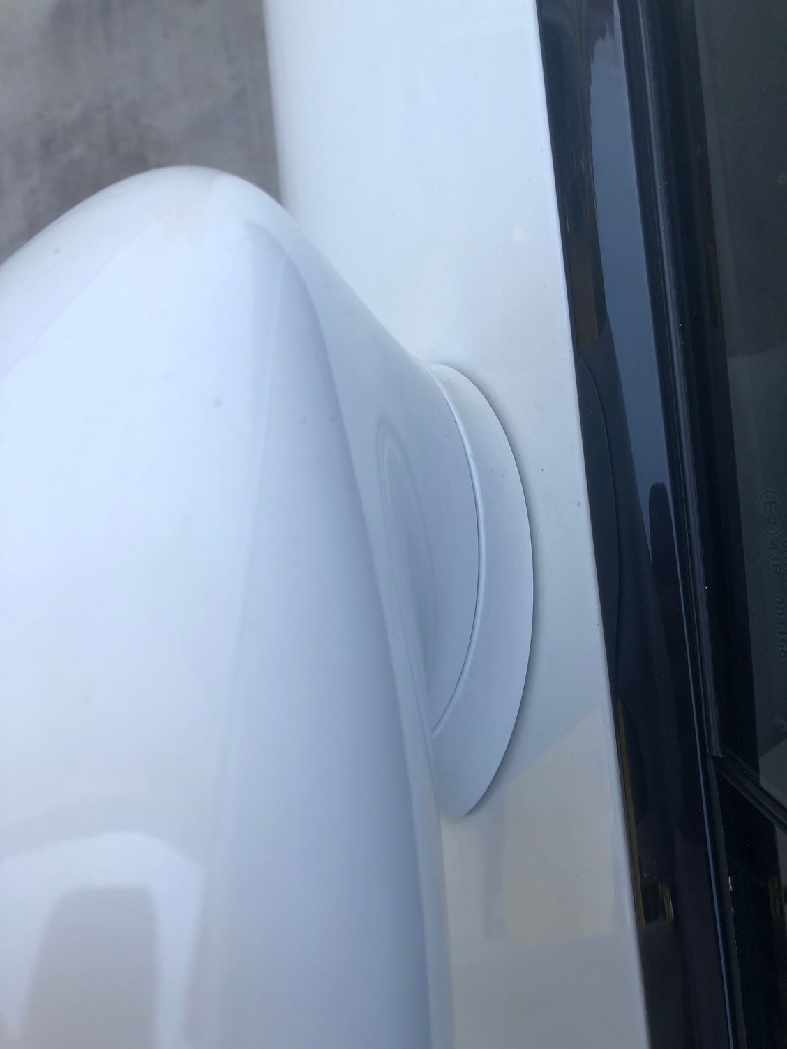

Old Jul 14, 2019 | 02:13 PM
jzchen's Avatar
5 Year Member
Joined: Jul 2019
Posts: 828
From: Arcadia, CA. USA
Rep Power: 40
jzchen is infamous around these parts

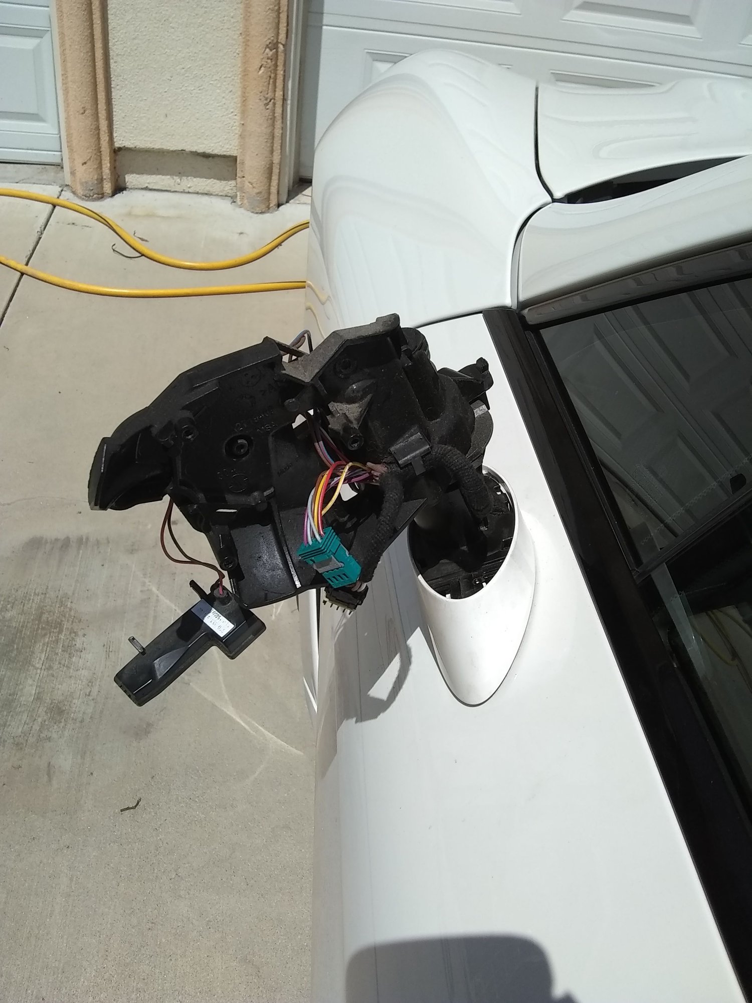

Misread Instructions, Now Stuck Temporarily!
Got this far and realized I missed the instruction to remove the mirror, which I did not get during the hour subscription! Argh! Base is stuck there, next step is to remove the mirror. Looks like removal of the interior door panel is next. Gonna have to pay another $14 to find it. I'll report when I get further...

Yes, we just bought it. The dealer did ask me to bring it back. I had the bright idea to ask if I could just take it directly to the repair shop, where the guy just said it’s normal, adjusted it way down and towards the car, because my complaint was that it made a huge blind spot as I couldn’t rotate it towards the body far enough. This worked to make it see the body of the car, but was a downward angle so again hard to see the lane beside. I basically spent the afternoon and got nowhere, except for a getting a decent alignment on the way home (long wait as they’re popular).
I wish I knew what the problem was, more specifically how to solve it. I can basically remove and replace the mirror now. I guess would that be the solution... Can’t find information on the issue in the subscription, nor how to adjust how far it rotates. What I did try was have the mirror rotate and attempt to pull the harness just as the mirror reached the correct spot, but it just kept rotating even with the harness pulled.
Sigh. Will contact the dealer if I have time today...

EDIT- Temporary Solution Only
Opened the interior door panel and found there’s no mechanical adjustment available, outside or inside. I subscribed one more time and found the wiring diagram. I carefully applied 12 V to pins 10-9, and it rotated. A couple more times and it was aligned up nicely!

Last night as I was finishing up I took my diagnostic scan tool and tried to clear all the codes I may have caused opening up the door and disconnecting electronics without disconnecting the battery. It cleared the two errors found, and then I found I was stuck inside the car! WHAT!!! I climbed over the center console and out through the passenger door. All the other doors worked. I had to use the manual key to unlock the door to get in. Also after the tool was done, the mirror turned back to the problem position (Argh, another temporary solution. As long as I don't activate the mirror park position then the mirror is fine.) Took apart the door, applied 12 V to the pins until it was correct again, then took a break as it was dark. This morning, before it gets hot, I went out and reinstalled the interior door panel and trim. I found that I did not push the trim back in completely, which was most likely the reason I was stuck inside, the handle came into contact with the trim towards the rear and wouldn't swing far enough to open the door.
Well, on to figuring out how to recalibrate the hall effect sensor memory I'm guessing......
