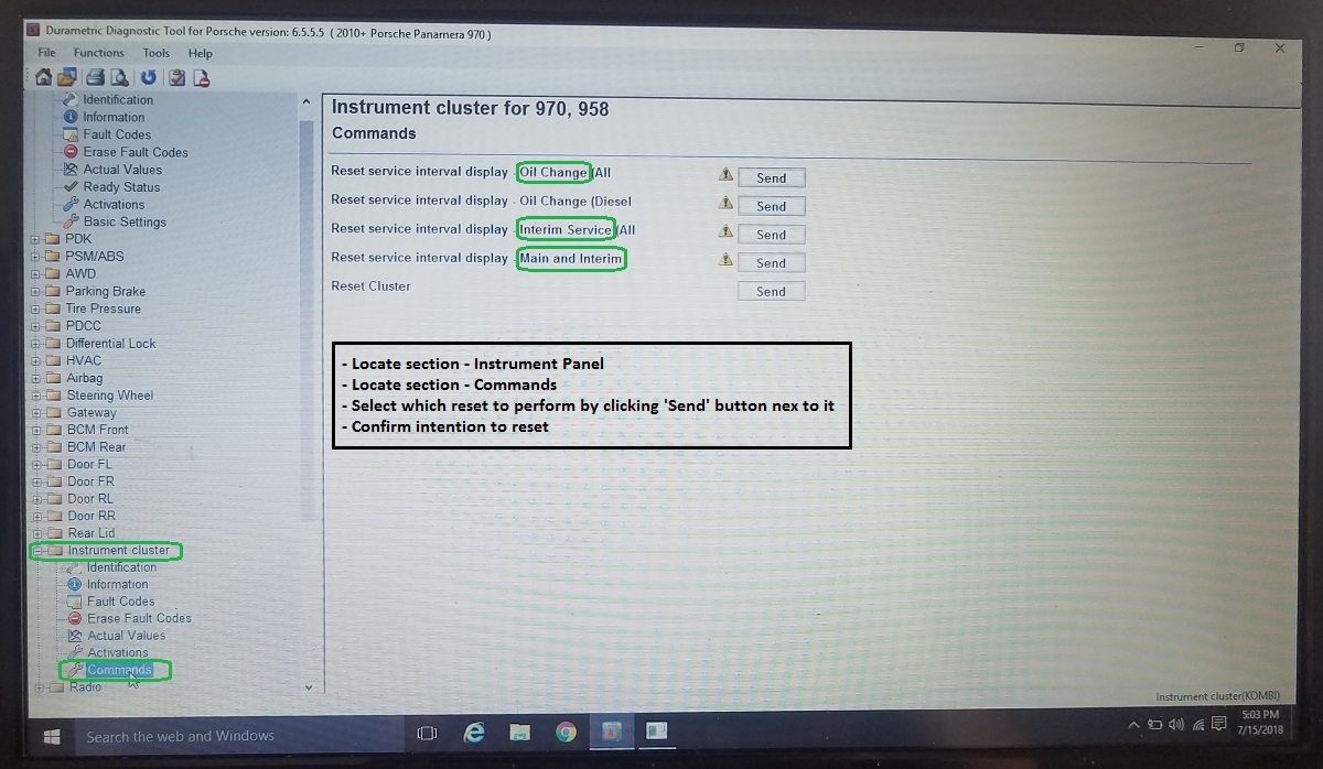

I see many asking how this is done with Durametric.
Here is the process.
Simple, and quick too.
Need to have Durametric cable (any flavor), plus SW from Durametric web site. My used version was 6.5.5.5.
Good luck.

Yes, I just reset oil in my p4s today with Durametric today. 6.5.5.5 is the latest update from Durametric.
